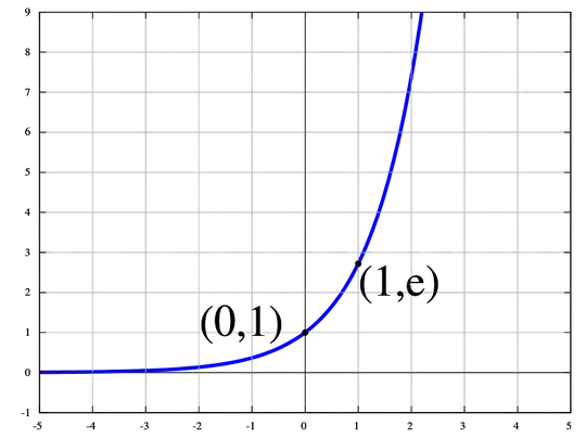

Instead, they have exponential behaviour, something like
$$r(t) = e^{\alpha + \beta s(t)}\tag1$$
where $s$ is the horizontal axis (input), and $r$ would be on the vertical axis (output).
Now, that's not very alike to what we want,
$$\hat r(t) = a \cdot s(t),\quad a\gg 1\text, \tag2$$
so how does that work out?

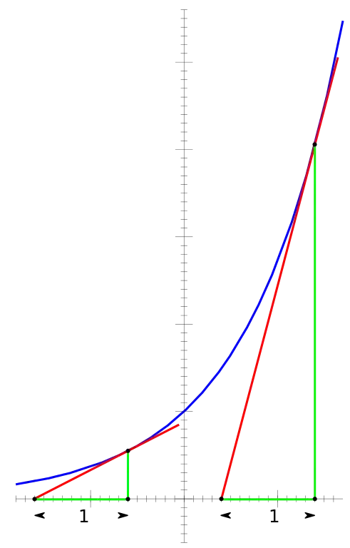

Well, you make sure that the $s(t)$ is relatively small and is offset with a bit of DC voltage so that you pick a region on that curve that is pretty steep and looks "flat enough", so that you land on the rightmost black dot in the below figure when $s=0$, and let $s$ vary just a bit so that the difference between the steep red line and the blue exponential curve is small:
Now, you have something that has approximately the linear behaviour from $(2)$ that we wanted.
But only approximately so. Maybe you've had some advanced math – if you did, you might know that the exponential function can be written as a series:
$$e^x = \sum_{k=0}^\infty \frac{x^k}{k!} = 1 + x + \frac{x^2}2 + \frac{x^3}{6} + \cdots$$
Of that, we've only covered the first to terms with our approximation:
$$e^x = \underbrace{1 + x}_{\text{red line approximation}} + \underbrace{\frac{x^2}2 + \frac{x^3}{6} + \cdots}_{\text{error terms}}$$
Now, when you mentally replace $x$ with your $s(t)$ in that error term, you see that you get your signal squared, cubed, …⁵ and so on as error terms, albeit with less amplitude the higher the exponent.
