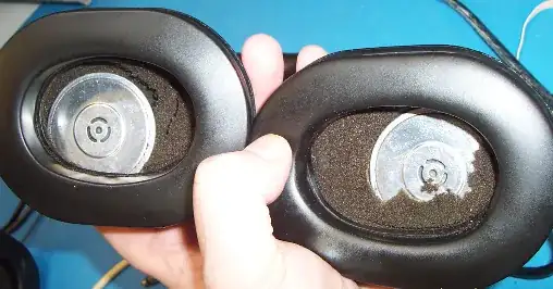

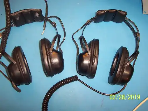

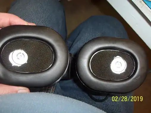

These are photos of the headphones that I use in my ham shack. As you can see, the dark gray foam rubber inside is deteriorating, and I need to replace it. It appears to be open-cell foam "rubber" between 1/8" and 3/16" thick.
One of the headphones has had little use (bought it as a spare) and shows the original size of the hole centered around the element's sound holes.
They are military surplus communications phones with just the right frequency response for SSB ham radio use.

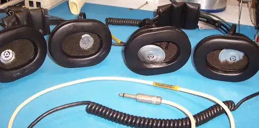

That foam is holding the elements in place. Notice that one element where there is almost no foam left is loose. However, it is not particularly stiff. That may or may not be because it is so deteriorated.
Does it matter what kind of foam is needed to replace this deteriorating stuff? Regardless, where can I get it? (It doesn't matter what color it is.)

To directly answer your question, the exact-replacement material would be open-celled polyurethane foam with a density of about 2.0 lb/ft^3 (30 kg/m^3). This can be found at just about any foam outlet store.
Alternatives:
  • It does not have to be polyurethane but I have found polyurethane to be far more durable than other foams.
  • The density can be adjusted; heavier foams will provide a little more absorption at lower frequencies and a little less at higher frequencies.
  • Open-celled foam is better for sound absorption than closed celled foam
Having said that, I understand the function is to reduce reverberation in the air space between the outer shell and the ear. For that, the best sound absorbers are fibers rather than foams. So a non-woven fiber such as Thinsulate or even a few cotton balls would work better than a foam. Materials such as this can be found in old coats or gloves.
@Doc 's suggestion of cotton socks is an excellent one. A little bit of absorption is lost due to the woven nature of the fibers, but it is still a very good absorber.
