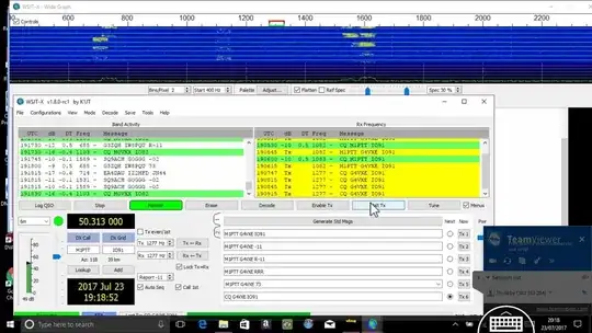

It's possible they're aircraft backscatter (ft8 signals bouncing from planes in the sky), or anything largely metallic really.
They look something like this.
t252
