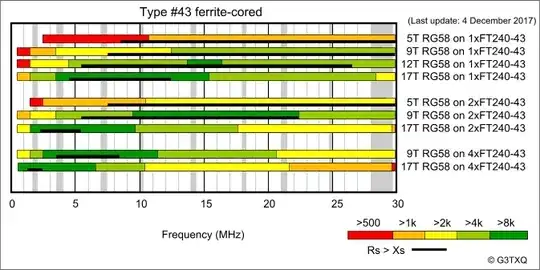

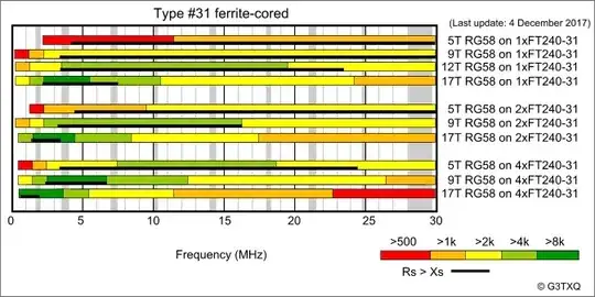

You may find some practical information regarding the number of turns of coax vs the core material on the G3TXQ (now an SK) site. Here are some examples of his analysis:

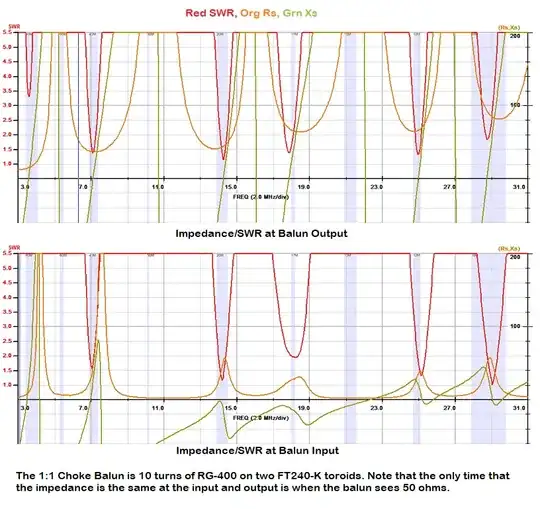

The advantage of using coax for a 1:1 choke-balun is the constant Z0 of 50 ohms. As can be seen in the following graphs, the only time a 1:1 choke-balun accomplishes a 1:1 transformation is when it sees 50 ohms at its output. Any other impedance at the output causes an impedance transformation because the SWR is not 1:1. enter image description here

  • Nice. And to clarify, this is true of either a choke wound with coax or a choke using bifilar windings, correct? – Mike Waters Mar 15 '19 at 01:07
    @MikeW, yes assuming the bifilar windings have a Z0 of 50 ohms which is sometimes a rash assumption sans measurements. The beauty of 50 ohm coax is that an assumption of 50 ohms is not rash. – Cecil - W5DXP Mar 15 '19 at 02:23
  • This is a very important and useful answer. It illustrates the fact that this is a "transmission line transformer" whose behavior depends on both the operating frequency in terms of the lengths of the transmission lines comprising the transformer and the impedances at the two ports. – Brian K1LI Mar 15 '19 at 12:59
