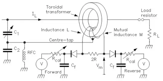

Assuming your SWR meter employs a variant of the Bruene Coupler$^1$, perhaps the most popular topology in use today, the short answer to your question is, "No," because your SWR meter is not measuring impedance. Rather, SWR is evaluated using the well-known relationship: $$SWR=\frac{V_f+V_r}{V_f-V_r}$$ where $V_f$ and $V_r$ represent the forward and reverse voltages at the point of measurement. Developing the representations of the forward and reverse voltages does not require "separating" forward and reverse waves traveling on a transmission line.
As described in The Bruene Directional Coupler and Transmission Lines by Gary Bold, ZL1AN:
The operation of the Bruene coupler is traditionally derived as if it's inserted in a transmission line, using the concepts of "forward" and "reflected" waves, which are assumed to exist on the line before and after it, and which flow through it. But the coupler also works when connected to: the input of a line; where there is no line on the "input" side; or when connected to a transmatch; or even to a pure resistance - which must always be done to calibrate it. There are no standing waves inside a transmatch or resistance, and the coupler itself doesn't contain a transmission line.
The Bruene Coupler - notice, it is not called a "bridge" - sums voltages to produce relative measurements of forward and reflected power. A capacitive divider ($C_1$ and $C_2$, below) across the input develops a sample of the RF voltage. Samples of the RF current from two halves of the center-tapped secondary winding of the toroid transformer pass through a resistor ($R$) to develop corresponding voltage representations of the RF current:
(Note that the voltage induced by the current sample results from $R$ rather than from $2R$ because, by virtue of circuit symmetry, the potential at the "center" of resistor $2R$ in the diagram is the same as the potential at the center tap of the transformer secondary. This connection is explicitly made in some designs.)
$V_m$, the "Reverse" meter voltage being measured in the diagram, comprises the difference between these two voltages. $V_m$ on the "Forward" half of resistor $2R$ comprises the sum of the two voltages because the voltage induced in $R$ by its half of the transformer secondary is $180^\circ$ out of phase with the voltage induced on the "Reverse" half of $2R$.
