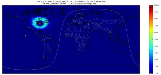

Let's try some simulations with VOACAP. In each case, the simulation is for UTC 20:00 for a transmitter in Michigan, USA (marked by the red dot) on 30 meters. The simulated antenna is a dipole 10 meters above ground at both receiver and transmitter, and the transmitter power is 1W. The colors on the map indicate the probability that communication will be possible, depending on conditions.
Here's the simulation for SSB:
Looks like about a 40% chance of some contacts in an approximately 600 mile radius, and no chance of anything outside that. Neat, but not especially thrilling. On some days, it may be impossible to make contacts at all.

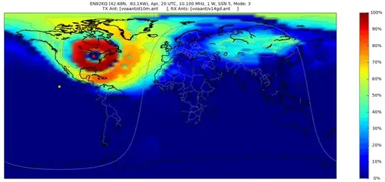

Now CW:
Within that primary 600 mile radius, the reliability is 90%. There's now some small chance of much longer range contacts, including Europe, Asia, and the Western US. While these contacts will require some good luck, for many people this is the thrill and challenge of QRP operation.

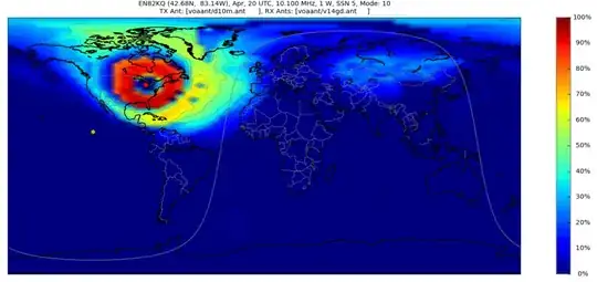

There are even more sensitive modes than CW. Here's a simulation for FT8:

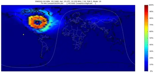

And WSPR:
While digital modes like FT8 and WSPR are more sensitive than CW, they require a computer to operate. Since CW is simple to implement electronically, and requires no computer, and is still sensitive enough to feasibly complete QRP contacts, many QRP kits are CW. For digital modes there are some QRP kits that are essentially the analog bits of an SDR which then interface to a computer soundcard to perform modulation and demodulation available for under $50 USD.
