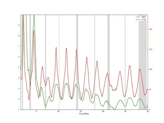

If I add about 10 meters of RG58 to the feeder the picture changes, but not much in terms of SWR:

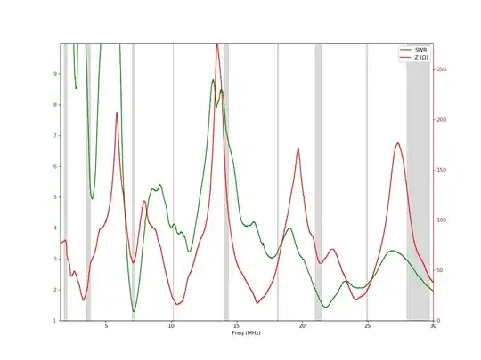

Finally, here is what I see if I measure SWR from the shack (about 30 meters of coax):

  • For the record - I observe the same behavior with 20M vertical. It's resonates only on 20M with short feeder, but suddenly I see low SWR on 10, 12 and 17M bands + SWR 2 on 15M with a long feeder. The shape of the graph is similar to the shown above. Two other SWR meters confirm this. I also got a confirmation from pskreporter.info that the antenna works on these bands and made a few QSOs in FT8 on 17M. – Aleksander Alekseev - R2AUK May 07 '19 at 22:18

    @natevw-AF7TB I have. The scan of the dummy load looks like this https://b.radikal.ru/b16/1905/d0/fa9f6a6a8116.png However when I do the scan through a long coax cable it starts to look like this https://b.radikal.ru/b13/1905/0c/ea2c02c6ecb8.png I tried different cables that I bought in different time in different shops and the pattern is always similar, although the longer the cable is the more distorted the image gets. I doubt that all these cables are defective as Brian suggests. It looks more like some sort of miscalibration or artifact of SARK100. – Aleksander Alekseev - R2AUK May 09 '19 at 17:33

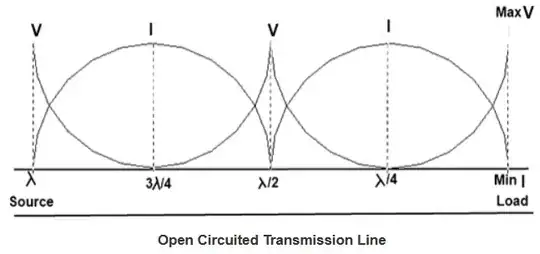

The repeating hi-Z measurements seen when SWR is measured with the 30m line suggest that it is defective. One needs to know the velocity factor and loss of the cable to determine the location of the defect. These should be determined from measurement, as actual lines can deviate significantly from published specifications and values can change as a result of electrical and environmental ageing.
As shown on DAE Notes, the impedance measured at the input to an open-circuited transmission line will be high at frequencies at which the line's electrical length is an even multiple of a half-wavelengh:
The fact that you observe similar behavior with a different antenna as the load reinforces this conclusion.
