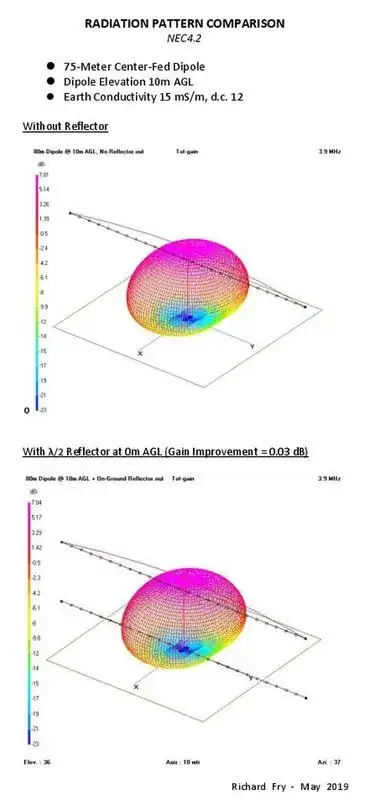

Below is the result of a NEC4.2 comparison of a 75m, center-fed dipole at 10m elevation above 15 mS/m Earth, with and without a reflector on the surface of the earth directly under it.
The gain improvement with the reflector is about 0.03 dB.
As for adding a single wire on the surface of the earth or buried several inches below the surface to improve the performance of a vertical monopole -- its effect on antenna system radiation performance would be close to negligible, also.
That single conductor, no matter how long it is, will be ineffective in collecting and re-radiating the r-f currents flowing on and just below the surface of the earth within a circle of 1/2WL radius from the base of a radiating monopole.

  • Thanks. What happens if the bottom wire is raised a little (~1 foot), Rich? – Mike Waters May 26 '19 at 18:25
    Mike - I set the elevation of that reflector at 0m AGL to match the recollection you had of that in your Answer. Elevating that reflector to 1 foot AGL increases the total, peak gain of that system to 7.4 dBi (other things equal). But maybe the reflector becomes a trip hazard? – Richard Fry May 26 '19 at 19:53
