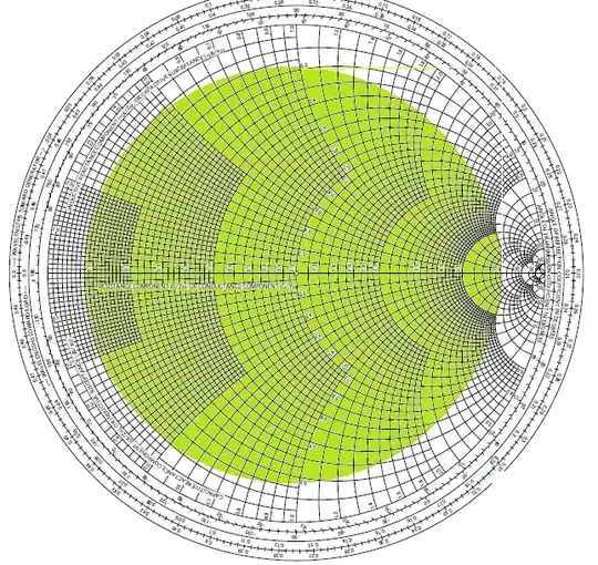

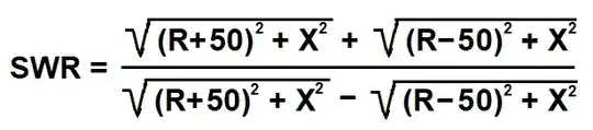

As you can see from the following equation, it is definitely not that easy. What I would do is draw a 10:1 SWR circle on a Smith Chart and assume that your tuner can match all of the infinite number of impedances inside that 10:1 SWR circle. If you don't know how to read impedances from a Smith Chart, it would be worth your while to learn how. The green area below on the Smith Chart normalized to 50 ohms is the advertised matching range for your tuner.
Cecil - W5DXP
  • 1,646
    Yes, this is the 10:1 circle. But given a basic Pi network, limited component values and a wide range of frequencies, it's probably more like an amoeba that changes shape over the bands, sometimes touching 10:1 ! – tomnexus Jun 04 '19 at 21:07
