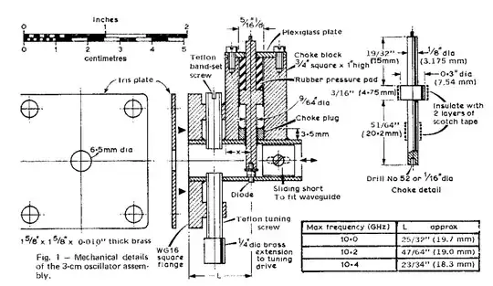

You might be able to use this mechanical drawing, from the ARRL's monthly QST magazine for August 1974, to determine whether the available units are appropriate to your needs:

  • Thanks. I don't understand the purpose of that top cavity however. It looks to be called the choke block. – Synaps3 Jun 10 '19 at 21:29
  • I thought the RF radiates from the iris, but they show it going through that choke block thing. – Synaps3 Jun 10 '19 at 21:30
    @Synaps3 It looks to me like RF exits through the 6.5mm diameter circular opening at the center of the iris plate. The iris plate mounts on the WG16 square flange. WG16 is spec'd for 6.557 to 13.114GHz operation. – Brian K1LI Jun 10 '19 at 23:58
  • @Synaps3 the choke block with that spindle-thingie which acts as current feed to the diode is actually a cavity of its own, instead of being a electronic component. Just "replaces" a coil (which could never have the Q of a cavity). – Marcus Müller Jun 11 '19 at 11:54
