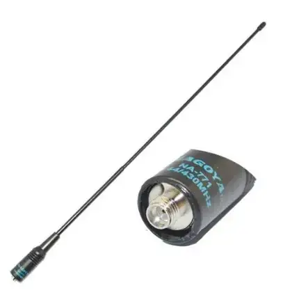

Every time I purchase a cheap HT such as the Baofeng you mention I also spend another $10 or so on an antenna, as the stock antenna is noticeably worse than even an inexpensive antenna like the Nagoya NA-771.
There are still better antennas than this, but there are always tradeoffs. The stock antenna is one third to half the length of the NA-771, which is useful in certain situations. There are vastly better, but more expensive, antennas that mount on and off the radio.
What you need will depend largely on what you're going to use the radio for. Given that you've chosen an inexpensive, low power (even for handheld) radio, though, I suspect you're really looking to improve things as much as possible while still retaining the portability and use as a handheld, without a lot of cost.
So the above antenna is my current recommendation in this situation.

    +1 on the Nagoya, I got one for my Baofeng farm (which I rotate through as batteries deplete). Although the performance is markedly better with the Nagoya, its length makes it unwieldy and almost impossible to use in a car. But I always keep it handy when mobile, just in case that extra drop of dB is needed to stay in contact. – Ron J. KD2EQS Feb 25 '14 at 14:08
    I have the 701 and wish I would have bought the 771 - though you are right, using it in the car would be tough, at least with the top up :) – KevinDTimm Feb 27 '14 at 15:49
    I wouldn't reccomend the nagoya, I got the genuine version, and just a little bumping around has made the top cap come loose, and scratches appear very easily. Get a diamond. – Skyler 440 Jun 07 '15 at 01:17
    As a little side question: will the longer NA-771 antenna still perform good on the extended frequencies that recent Baofengs can reach? The older Baofengs could go up to 480 Mhz, while the newer ones go up to 520 Mhz so I was wondering if the original, shorter Baofeng antenna could outperform the a NA-771 at those shorter wavelengths? – Redoman Oct 21 '16 at 10:30

Nagoya NA-771
Nagoya NA-771
Cost: $11 on Amazon.com as of March 2014
Length: 396mm
Weight: 37g

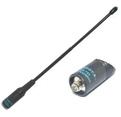

Nagoya NA-701
Nagoya NA-701
Cost: $10 on Amazon.com as of March 2014
Length: 211mm
Weight: 40g

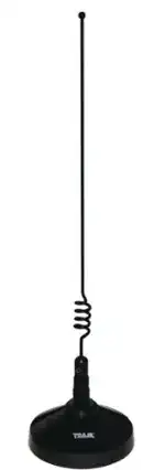

Tram 1185
Tram 1185
Cost: $16 (+7 for adapter) on Amazon.com as of March 2014
Length: 19 inches with magnet mount

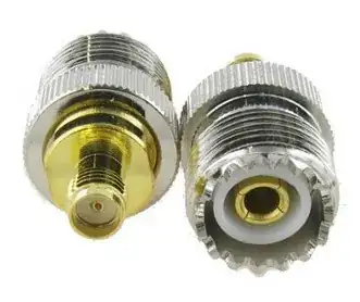

Will require SMA female to UHF female RF adapter which is
$7 on Amazon.com as of March 2014

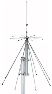

For base operations, I am rather partial to the Super Discone for transceiving. I paid $69.95 for it brand new.
It is very wideband.
Note that it has a SO-239 connector, so you will want good coax with PL-259 connectors.
Then you need a pigtail adapter to connect it to the radio.
It is obviously not as effective as a tuned yagi for point-to-point, but if you are looking for an omnidirectional, flexible base station antenna, this is the one that I chose. And I'm glad I did.
