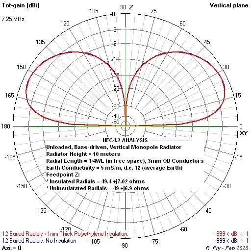

Developing this comment of W2ASC (above): But, given the fact that radials are effective even when buried in a few inches of soil, my assumption was (and still is) that whatever difference exists between the two insulation types is - for all practical purposes - negligible. So, my question is probably a bit academic. I still believe my initial assumption was probably correct, I just don’t know how to do the math to confirm it. Can anyone confirm or refute?
Below is a comparison that might be useful, showing the effects of bare vs. insulated buried radials (other things equal).

    I don't see the blue plot. I presume that's because the red plot is right on top of it, meaning that there is a negligible difference in performance between the two radial systems? – rclocher3 Feb 03 '20 at 14:26
    @rclocher3 Yes. You can see some blue if you zoom in. – Mike Waters Feb 03 '20 at 15:34
