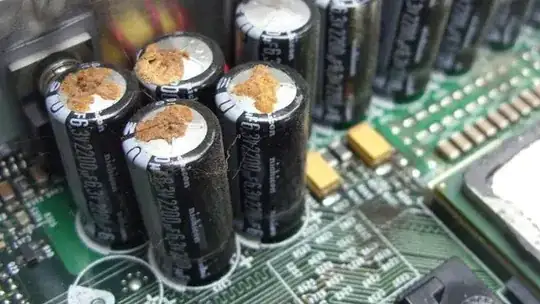

  • The most likely sort of leak one might find is an electrolytic capacitor losing its electrolyte, but that is more likely to make a circuit board corroded and stained in the vicinity than to manage to escape the housing. And the electrolyte would be mostly colorless/white appearing.

Wall warts aren't terribly complicated devices, they're just small transformers to convert the commercial AC into low voltage DC. There won't be any batteries in it, but there are likely capacitors. As noted here, the electrolyte is mildly toxic and corrosive, but not to the point where it's a significant HAZMAT issue. Just clean it up with a paper towel and wash your hands with soap and water.

Electronics don't commonly leak, especially not new ones. It is not unheard of though, particularly in older electronics, like the capacitors in this article. But even then, they shouldn't produce enough fluid to run all over the floor.
