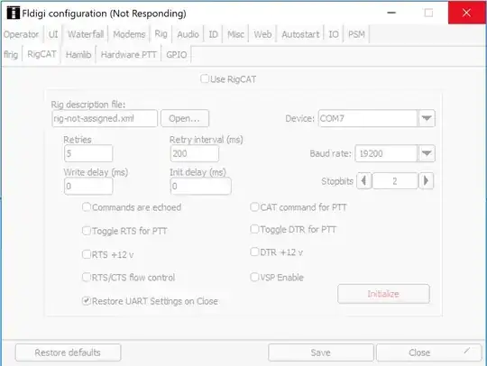

I am trying to setup FLDigi with my ICOM-7300 via the USB connection so I can start using digital modes. Everytime I try to follow the instructions here, it doesn't work. Specifically, everytime I try to load the .xml file, FLDigi hangs up and crashes.
I tried using the Hamlib definition for the radio, and I can see it has made some kind of connection because whenever I rotate the VFO on the radio, the FLDigi frequency display changes, and vice versa when I change that frequency the radio changes.
However, I am receiving nothing on the waterfall display, and when I center on digital signals in the low end of the 40m band FLDigi doesn't decode anything. Not even a garbled signal that might indicate I'm on the wrong encoding protocol.
What am I doing wrong, and what do I need to do to get the radio data into FLDigi in addition to the rig control features?
