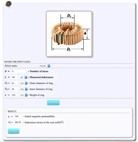

Next, we enter our measured inductance into a calculator like this one along with our toroid dimensions.
In this test, my results were the following: Results As you can see, we are almost dead on for initial permeability and well within the datasheet specs for AL(nH) = 1075 ±20%. Once you know the core material type, you can then use that to reference it's usable application.

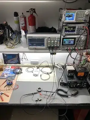

We can perform other simple tests such as testing what frequencies are passed or blocked in configurations like this to help determine if the unknown core will work for our application. Here are a couple of examples.

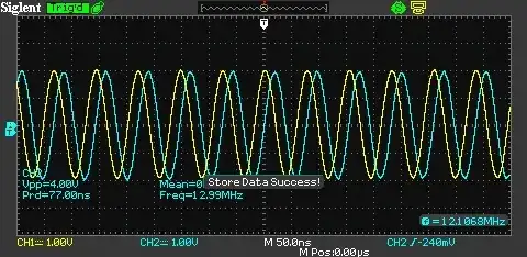

Here we are injecting a 4Vpp sine wave on one coil of 5 turns around our type 43 core and viewing that signal at both sides of the winding. Notice as we sweep from 25MHz to 1MHz the changes that take place. Most notably, we can see a phase shift as the output signal (blue) lags the input (yellow) more as we go up in frequency (less as we go down). Also, note the output's amplitude is lowest at 25HMz, highest around 8MHz, and matches the input as we approach 1MHz. These are both useful to know in determining what this chunk of ceramic might be good for.
Test setup 2 Core winding and connections 25 to 1MHz sweep
