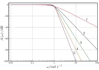

The practical application for the ham is this: the more poles or zeros a filter has, or the higher the filter's order, the steeper the roll-off can be. An an example, here's the frequency response for a number of Butterworth low-pass filters with different numbers of poles:
The numbers by the lines, 1 through 5, denote the order of the filter. For a Butterworth filter, the order is also equal to the number of poles. As we add more poles, the roll-off becomes steeper. Again just for Butterworth filters, the roll-off is 6dB/octave for each pole, so a 6-pole filter would have a roll-off of 36dB/octave, and an 8-pole filter would be 48dB/octave. Other filter designs can achieve a steeper roll-off at the expense of some other property, such as ripple.
