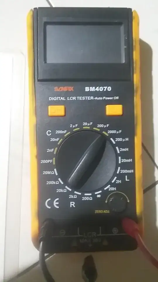

I would like to make a match half wave length (λ) dipole antenna (or probably a short dipole antenna). So I would like to make it by measure using LCR meter.
What I am still confuse is about what is the correct formula of impedance (Z). Is in most explanations the formula is written that impedance (Z) = R + jX (Ω), which X is capacitance (and inductance if any). The resistance, the capacitance, and the inductance (if any). As there will be imaginary component there, then the unit will not be ohm (Ω). Then the question is, which one is the correct one for this two formulas (assuming no inductance)?

    Your "digital LCR tester" will only give you the reactance (inductive or capacitive) at the meter's test frequency. This is probably very far from the frequency on which you want to use the antenna, so it will not be helpful. – Brian K1LI Aug 03 '19 at 10:58

In practice, you won't be able to measure the impedance of your antenna with an LCR meter. As you can see in equations 1 and 2, reactance (and thus impedance) depends on frequency. The LCR meter works by measuring the impedance at some frequency, then working backwards though equations 1 or 2 to find the inductance or capacitance.
This works OK for inductors and capacitors (at least, when operating at frequencies where parasitic effects are negligible), but an antenna is something else so equations 1 and 2 don't apply.
Instead, people use an antenna analyzer to measure the impedance directly at the frequency where the antenna is intended to be used.

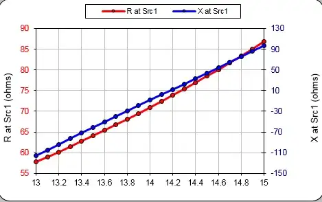

In general, impedance consists of two parts: a resistive part that dissipates energy and a reactive part that stores energy in an electric or magnetic field. A complex number that includes a real part and an imaginary part is a mathematical tool for keeping track of two related properties of a system. On a Cartesian graph, the real part (resistance) is plotted along the $x$-axis, while the imaginary part (reactance) is plotted along the $y$-axis. By convention, inductive reactance has a positive sign and capacitive reactance has a negative sign. The distance from the origin of the graph to the point $(x,y)$ corresponding to the impedance of interest is the magnitude of the impedance, while the angle of a line segment from the origin to the point is the phase angle of the impedance, as shown in the diagram:
Your first equation should read: $Z=R-j\frac{1}{2\pi fC}$ (note the change of sign). If the reactive part of the impedance was inductive, the equation would be: $Z=R+j2\pi fL$. Your second equation is the magnitude of the impedance: $|Z|=\sqrt{R^2+X^2}$, where $X$ is the inductive or capacitive reactance calculated earlier. The companion of the magnitude of the impedance is its phase angle, which is $arctan\frac{X}{R}$.
Using the simple example of a half-wave dipole, the impedance at the feed point would: be purely resistive at the resonant frequency $(R+j0)$; show capacitive reactance below the resonant frequency $(R-jX_C)$; show inductive reactance above the resonant frequency $(R+jX_L)$. The graph below illustrates this behavior for a half-wave dipole designed for the 20m amateur band (14.1MHz):
Measuring the same dipole's feed point impedance with an $LCR$ meter operating at 100kHz would produce a measurement of $0-j88184 \Omega$, which is equivalent to an 18pF capacitor. Why? At this very low frequency, the 20m dipole is only 0.003 wavelengths long, so it will only radiate (dissipate) a very small amount of energy; thus, the resistive part of the impedance is very small. The capacitive coupling between the two dipole legs dominates the small inductance of the short wires, so the reactance is capacitive.

  • I am very confused now. I normally used that LCR meter to test value of a capacitor or inductor. i.e: I bought an elco capacitor, there written 1000uF/16v. Then I have to test what is the actual value of that capacitor. Then I got 980uF. Then it is considered actual, or closed to the written value. To do calculation, of course I will use the actual value rather then the written value. Just that simple. I don't have to bother about frequency. Am I wrong with my measurement? To do calculation, we only need the C (F) while the f (Hz) is the given value, right? – Sitorus Aug 03 '19 at 13:26
    Your measurement of a capacitor is correct, *but an antenna is not a capacitor.* An antenna is more like a transmission line. Measuring it as if it was a lumped element, like a capacitor or inductor, will lead to errors. – Brian K1LI Aug 03 '19 at 15:31
