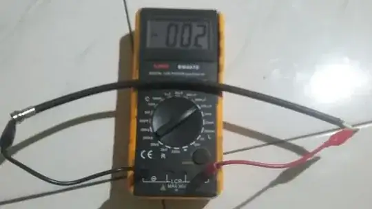

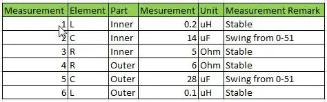

Here is my measurement to a piece of RG6 cable. It is around 30cm cable. On the shield is written COAXIAL CABLE 5C-2V 75 ohm. From my measurement I got data as below: Electronic Measurement
From that table, we can see that there is significant impedance of the cable. If we calculate the inner and the outer impedance using formula Z=R+j(XL-XC), where XL=j2pifL, and XC=j/(2pifC), L in Henry, C in Farad, f in Hertz, and pi=3.14159265358979. Calculation with the data below and using 2,100 MHz frquency, I got as below:
  • Z inner=5+j2638.9 ohm, and
  • Z outer=6+j1319.5 ohm.
Then my question is:
  • What is the 75 ohm meaning (written at the the cable shield)?
  • What is those two impedance meaning to the antenna?
  • If we got data in real cable, what to do to match the impedance?
Edit: The cable was just used for C-Band parabolic antenna.

  • @BrianK1LI, why does the capacitance of my cable is almost one million times higher than the spec you gave? Sometime the measurement shows 51 micro. But, it was micro, not pic. From my measurement, the impedance were very high. Impedance of the inner and the outer. – Sitorus Aug 06 '19 at 13:57
  • @Sitorus you're really confusing very different things here! I can't stress this more than I and others already did: get a basic book on transmission line theory. Do the basics. There's no sensible shortcut. – Marcus Müller Aug 06 '19 at 15:23
  • @Sitorus If you don't get the values shown in the spec sheet, you are probably not using your LCR meter correctly. For example, your table of values shows "inner" and "outer;" there is no "inner" or "outer." You must follow exactly the procedure in the link I sent earlier. – Brian K1LI Aug 06 '19 at 17:28

You have mixed up the characteristic impedance of a coaxial cable with the DC impedance measured from a piece of that cable. So I'll tell you what you measured and then what you could have done instead.
  • First of all, I have no idea what does it mean to measure a capacitance with a multimeter when you have connected both measurement leads to the same piece of wire. Probably your multimeter doesn't know either and that's why you got the wildy swinging numbers. Capacitance is a measure of how much electric charge (electrons) is stored in a capacitor. If you would have a bit of ripple in any voltage, this charge could be used to "even out" the variations. If you measure the capacitance between the inner and outer wire, it would be more useful. I would forget your measurement results completely.
  • The inductance measurement already makes more sense: it tells you how strongly anything (your cable in this case) fights against the current from changing. Again, inductance can be useful in a filter. Longer cable means more inductance. In your measurement, probably a great deal of measured inductance is created by the fact that the measurement leads form a loop. If you repeat the "L outer" measurement and start turning the cable in all kinds of crazy shapes, you'll get much higher inductances.
  • The resistance you have measured tells us about the losses in your circuit. It basically tells you how much is the voltage loss along the cable if a known current goes through the cable. If you have a longer cable, there will be more losses.
So that's what you measured, and I'm sorry to say but all of that was nonsense. When we are talking about characteristic impedance of a coaxial cable, we mean the ratio of current going along the wire and the voltage between the inner and outer conductor. Although the wire has impedance of $75 \Omega$, this doesn't say anything about losses. As others have pointed out, you can measure the capacitance per unit length and the inductance per unit length and then calculate the characteristic impedance of the cable from $Z=\sqrt{L/C}$, but the multimeter accuracy is just not enough.
  • What is the 75 ohm meaning (written at the the cable shield)? The characteristic impedance is a property of the raw cable that tells you the ratio of voltage and current of a wave travelling through the cable.
  • What is those two impedance meaning to the antenna? In this case (I assume you have a commercial satellite TV dish antenna) the only importance is that all components in the chain must have the same impedance: the antenna has been "matched" so that the output impedance is $75 \Omega$, your cable is $75 \Omega$, and finally the actual receiver is designed so that it works best when it sees $75 \Omega$ impedance. Changes in impedance mean that power is reflected (and then lost).
  • If we got data in real cable, what to do to match the impedance? You can trust the impedance written in the cable jacket. You don't match impedance of the cable, you must match the impedance of the antenna as seen through the cable. If you can measure the actual impedance (at RF frequency, not multimeter) of the system of antenna and cable, maybe you can ask a new question on how to match that to $75 \Omega$ or $50 \Omega$ (or what ever impedance you choose to use in your system).
