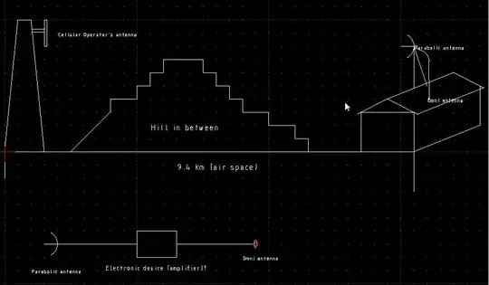

Consider a situation as below. I am stay in a farm field, which my house is 9.4km distance from the nearest and the only one BTS (Base Transceiver System), a cellular antenna for transmit and receive signal of 2G/3G network. Measurement I did using Google. In between my house and the BTS, there is hill which block direct signal to the house. If I climb to a three near my house around 8 meter high, I will get signal around 93dBm (up and down). Then I think to make an outdoor parabolic antenna which will be connected by a coax cable to an indoor omni antenna which will serve 360 degree inside the house 5 meter radius. The diagram is as in the picture below. The outdoor antenna itself will compensate the cable loss plus will give more gain. I expect I will get around 90 dBm signal strength after installing the antenna. For now, forget about the antenna detail.
To get the signal in the house, I probably need an electronic device located in between outdoor (parabolic) and indoor (omni) antenna. That device is intended to receive that signal from outdoor and send to indoor without any modification or amplification, just to make the indoor antenna will radiate signal. And vice versa also will do, to send the received signal from indoor and delivered to the outdoor antenna and radiate to send it to the BTS.

schematic diagram

  • I am not 100% sure, but you are trying to make something like [this](https://ham.stackexchange.com/questions/9244/two-devices-one-antenna)? Right? – Duck Dodgers Aug 08 '19 at 08:20
  • What is such different with amateur radio? Still using antenna, capacitor, inductor, feeder line, and the most important, feeder line, right? Unless I asked about cellular modulation, and so on. I clearly said in the last sentence in the first paragraph: **_"For now, forget about the antenna detail."_** My question how to make a received signal from one antenna and pass it to another antenna without any changing. That's the whole problem, the whole question. How to do it. Preferred if without any device. That mean, if any other way, like do induction, etc. – Sitorus Aug 08 '19 at 08:24
  • @DuckDodgers, not it is not. What I want is closer to what is shown in [this video](https://www.youtube.com/watch?v=bHWrRG_kdn8). Unfortunately, no detail how it work. Need guide how to make the part that is attached to the back side of the phone. That one also will do. – Sitorus Aug 08 '19 at 09:28

  • @ChrisK8NVH, As in the video, he made an external Yagi Antenna to receive signal, connected a coax cable to it. And the end of the cable is put to the back of the phone. And he claimed the signal is better after the external antenna. That almost solve my question. But that way has limitation as not free to move. What I want is another end is connected to another antenna which will transmit power to the mobile phone. – Sitorus Aug 08 '19 at 11:35

  • @tomnexus, how does the system work? How the directional antenna (24dBi) receive signal and the omni-directional antenna will transmit the received signal by the directional antenna without any active device in between? – Sitorus Aug 09 '19 at 04:50
