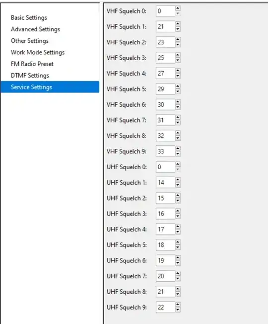

Premise: I had a Baofeng GT-3 TP Mark III 8W stored and never used, this morning my nephew has found It and He tried to "play with It" transmitting at maximum power(8 Watt) despite antenna wasn't attached, (seems He has transmitted for several minutes).
Now I have tried the radio in a near range indoor transmission and in channel mode apparently seems working, but in frequency mode It activates on all frequencies, as there is an incoming transmission, but It receives noise on all frequencies even at maximum squelch level (9).
Since I haven't tried this radio before, I don't know if this depends on local radio pollution and bad factory squelch parameters, that eventually I can adjust with CHIRP(you can see the current parameters in the image), or this could be caused by some noise filtering component that has been burned during the transmission without antenna making It more sensitive to any radio disturbance. the squelch levels setting currently on the radio

If your nephew damaged the Baofeng GT-3TP Mark III, the damage is likely to the transmitting circuits of the radio, and not to the receive side. I don't have that model of Baofeng, but I do have a different model, which is notorious for having difficult-to-adjust squelch. On several channels I can't get the squelch to stop the radio from playing static. It could be that the squelch hasn't been improved much in the GT-3TP Mark III.
If the radio has been damaged, the most likely symptoms are low transmit power (perhaps none) and/or high current usage. The best way to test the radio would be to compare the transmit power and current draw to a unit that hasn't been transmitted without an antenna. If you don't have access to a second radio and test equipment, then you could try asking for a radio check on a local repeater or your local 2m FM simplex calling frequency (146.52 MHz in the US and Canada). You could also keep an eye on how long the battery lasts, and compare that to other operators' experience.
