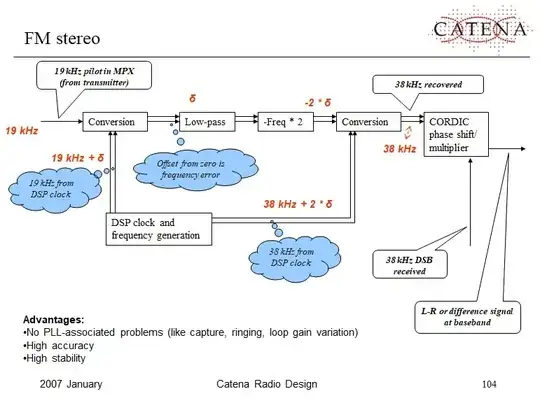

To come back to your question: it is not necessary to make that analog PLL for subcarrier 38 kHz synchronous detection in the digital domain. With a complex multiplier or a CORDIC it is possible to multiply a DSP-clock frequency of about 19 kHz, not exactly but close, multiply estimated (generated) 19 kHz with the pilot tone, and filter the output low-pass (this error signal is the offset frequency between the two systems) and construct the wanted 38 kHz with correct frequency and phase. This is a feed-forward system without locking. The figure attached is easier to understand than my words. PA0FSB Copyright for the document: I am the source.enter image description here
