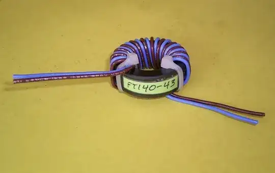

  • Both documents suggested above are a wealth of information. I have an FT140-43 torroid that I bought to fit in the balun enclosure. Maybe there is something not right about that old ferrite rod I used. I'll make a torroid balun and report back. I don't know how my 1.4" torroid core compares to the 2.4", but in the charts the 4" compared to the 2.4" uses the same 12 turns. – Peter Buxton Aug 24 '19 at 03:09
I'm answering my own question after seemingly solving the problem, thanks to the helpful comments I received. Evidently, the ferrite rod core that I salvaged from a Hy-Gain balun was the culprit. I couldn't find any information on what kind of ferrite it is but it was manufactured about 30 years ago. I don't know much about baluns yet but earlier questions I had about that same stock Hy-Gain balun prompted me to post Voltage vs. Current Balun for Dipole.
So the solution is, I wound a new balun per info in http://audiosystemsgroup.com/2018Cookbook.pdf. Although the document says to use a 2.4" #31 torroid core, I had a 1.4" #43 core so I wound it with #20 wire just to test if it would work. enter image description here Now there is no increase in common mode current as was measured before, and the SWR is only 0.1 higher than without the balun, so I think this qualifies as solved. Hopefully this post can somehow help others with similar questions.
