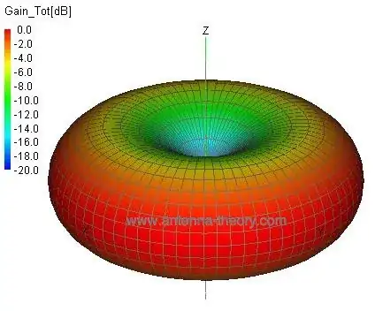

Let's assume that this antenna you describe, when operated at 145 MHz, has an SWR of 1:1, and behaves like an ideal antenna. At 145 MHz, the 1/4 wave vertical, plus the image antenna formed by the ground plane, make it effectively like a 1/2 wave dipole. It will have a free-space radiation pattern like this, for an antenna oriented vertically along the Z-axis:
0.5 WL antenna pattern

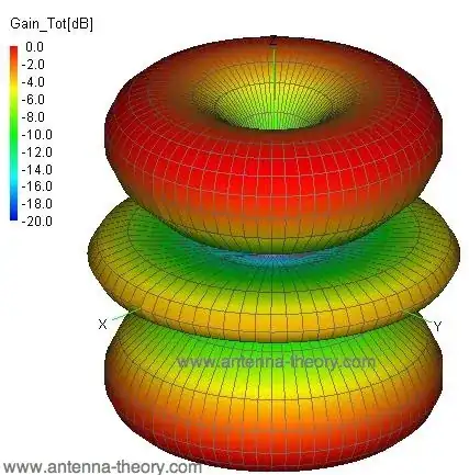

However, the radiation pattern is different, because now it's not a 1/2 wavelength dipole, but a 1 1/2 wavelength dipole. The radiation pattern looks like this:
1.5 WL antenna pattern
In the latter case, at 435 MHz, the maximum gain is the same as it was at 145 MHz. However, the lobes are narrower, and higher elevation. There's a secondary lobe around the horizon, but it's even narrower, and about 4 dB below the main lobes.
