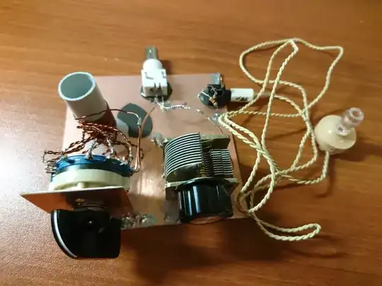

I'm learning to build radio receivers and transmitters. I've successfully build some oscillators, amplifiers and filters before and decided that to build a simple crystal radio would be a logical step further. I wanted to build a crystal radio for ~7-8 MHz because I have a good antenna for 40 m band and during the night there are always many strong AM signals (typically S9+30 and even above) around 7.200-7.300 MHz.
Here is how my radio looks like:
The inductance of the coil is about 8 uH. It has 12 taps with 6th tap around 3.7 uH. The capacitor is 12..365 pF, the diode - 1N34 and the resistor - 51 kOhm. One way or another (considering stray capacitance, not exact inductance of the coil, etc) it supposed to tune somewhere around the frequency of interest:

I tested the radio using a signal generator and an oscilloscope and confirmed that the BPF (LC-network) works as expected. The radio is also capable to receive a 5 W CW signal from my transmitter with the transmitting antenna placed about 20 meters away from the receiving antenna. The radio doesn't receive anything when I transmit on 20 m band.
However no matter how I tried I didn't manage to receive any AM stations. I've noticed though that if I briefly transmit an 5 W AM carrier on the frequency of the AM station (not something I supposed to do...) I can hear this particular station reasonably well while I'm transmitting.
I tried to change the coil, the resistor and add/remove capacitors in series and parallel to the variable capacitor for quite some time. At this point I doubt that I will get any better results.
What brings me to the question I have. I don't know whether such a low sensitivity of a crystal radio is expected for this band (maybe this is the reason why most people make crystal radios for 0.5-1.6 MHz?) or maybe I did something wrong. Is it worth trying to make any further tests or improvements to the radio (in this case, which one?) or it's as good as a simple crystal radio will be and I should move forward to other types of receivers (e.g. superheterodyne)?

I notice you have a BNC antenna socket, so I wonder if you're having the same problem I once had. I built a crystal radio kit, attached it to my HF antenna, and got essentially nothing. I then followed the kit instructions for a long-wire antenna connected directly to the terminals of the kit, and got much better results even though that antenna was strung up indoors.
In other words, consider whether you have an impedance matching problem between the antenna and the radio. Try an impedance transformer or a different antenna with much higher impedance.

  • You were right. I attached the radio to my 40m delta loop directly (without any impedance matching), and could here many AM stations. Though this could be not only because of impedance matching problem, but also because of losses in the ATU and the coax. Another problem I had - turned out that the 1N34 diode I've been using was fake, with 0.7V voltage drop. Naturally I replaced it with a genuine one. – Aleksander Alekseev - R2AUK Nov 25 '19 at 12:42
