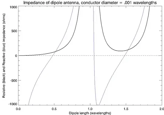

Read it off this chart:
enter image description here Interferometrist [CC BY-SA 4.0], via Wikimedia Commons
A folded dipole with equal-sized conductors has 4x the impedance of an ordinary dipole.
The impedance repeats every wavelength, so for example if you're interested in the impedance at 2.5 wavelengths (off the chart) it won't be far off from the impedance at 1.5 wavelengths.
Height above ground, conductor diameter, and non-straightness of the dipole elements can alter the impedance, but if you just want a rough estimation this will do just fine.
