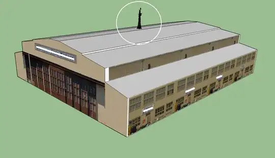

  1. We have a VHF Omni directional antenna, 2.5 W and 119 MHZ (approximate) mounted on top of a commercial hanger. Access to the antenna is out of the question because of the lack of fall protection. Service personnel have expressed apprehension over accessing the antenna.
  2. We’re trying to come up with a solution that minimizes the risk to service personnel

  • Technicians are apprehensive of going up there. There are no railings or handholds or tie offs. The surface is deteriorating. Its pretty dangerous. – Cof Fee Oct 16 '19 at 16:37
  • The VHF transmitter is inside the building and can't be moved. Its linked to a lot of Weather Equipment. We are stuck with using the building to mount the antenna. – Cof Fee Oct 16 '19 at 16:39

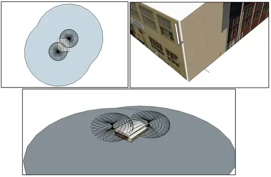

    6. A major concern is that an unexpected beam pattern would result. a. We don’t know if the ideal result, shown below, would result. b. We could have a beam pattern with some unintended results. – Cof Fee Oct 16 '19 at 17:42

When you feed two antennas with equal power and the separation is large you would create a pattern with very deep nulls at points where both antennas are visible.With the proposed arrangement that would be two 90 degree sectors with problematic coverage. A better solution would be to use the hanger as a screen to minimize the sectors where both antennas are seen equally well. That would be at the midpoints of the long sides and close to the vertical wall. Maybe below the lower roof in case you do not need the range associated with more antenna height. Cable lengths do not matter and you should use a simple power splitter because in case there is any unbalance there is nothing to gain by heating the resistor in a Wilkinson splitter/combiner. 119 MHz seems to me like aeronautical. If that is the case so the signal arrives from some elevation, use a low height and do your best to minimize the directions from which both antennas are visible - but of course high enough to avoid obstacles that might screen the signal.
