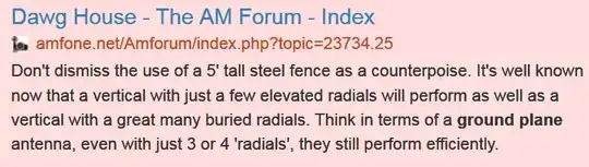

Googling for chicken fencing ground plane
