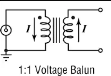

Everyone knows that balun stands for Balanced to Unbalanced and is an AC electrical device which can be used as an impedance transformer and is also used to convert an unbalanced or single ended AC system to a balanced or differential AC system and vice versa.
A common example of usage of this device is to enable an unbalanced coaxial transmission line to be used to feed a balanced dipole antenna split in the middle with the feed point in the center.
Very quickly, there are a few different types of balun :
  1. Voltage balun which behaves like an isolation transformer and removes the DC ground or common connection between input and output and allows the output to 'float'.
  2. Current balun which allows conversion from balanced to unbalanced but with a ground or common connection between input and output thereby referencing one side of the balanced system to the same ground as the input.
  3. Delay line baluns which used 1/4 wave length sections of coax cable as impedance transformers.

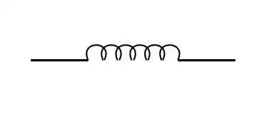

One of the desirable effects of using a voltage balun with coax and a dipole antenna for example is that because the balun is a low impedance device which blocks common mode current, all of the current present on the inside of the coax is transferred through the balun and no current can split up at the end of the coax braid and flow down the outside of the coax.
This prevents an undesirable effect commonly known as "common mode current on the outside of the coax" which basically makes the outside of the coax part of the antenna.
Because an RF choke can prevent current on the outside of coax just like a voltage balun does, confusion has arisen and there is a widespread belief that when used with an antenna an RF choke is a balun.
Unfortunately while both devices can produce one same result amongst many variables, this common misconception also confuses anyone trying to understand how antennas and transmission lines work.
An RF choke is in fact not a balun and doesn't convert a balanced to unbalanced system at all, but rather is an inferior band-aide solution to get ridding of common mode current.
An RF choke can't be used on it's own as an impedance transformer, and if you use coax with a balanced dipole antenna and an RF choke in line to stop the common mode current on the outside of the coax problem, you still end up with an unbalanced dipole with one side which has a DC connection to the ground of the input, which is not the same result you get with a voltage balun which provides DC isolation between input and output.
Also it's far easier to get an acceptable common mode rejection using a proper balun to get rid of undesirable common mode current than it is to get the exact impedance required in an RF choke to block the same current, especially since the effectiveness of an RF choke is highly frequency dependent whereas a balun isn't as much.
Saying that an RF choke is a balun because both things block common mode current is the same thing as saying that a hammer is a brick because you can use both to bang in nails so let's all build our houses out of hammers, or sea water is the same as tap water because there are fish in both so it's ok to drink both, etc. !
The result is that there are probably many antenna installations out there with a dipole for the driven element that don't work as well as they could because one side of the antenna has a DC connection to ground causing an unbalance in what is supposed to be a balanced system, and with RF chokes which don't actually block that much common mode current, thereby messing up the radiation pattern and being more susceptible to local interference, where a real balun wouldn't have these problems.
Hope that all makes sense !

  • @Mike Waters In my opinion the point system on sites like stack exchange don't work when many people believe something that's false. The perfect example of this is the widespread belief by ham radios operators that inductive and capacitive reactances cancel at resonance for a dipole antenna, which is simply not true. When everyone agrees that a false idea is true and then down vote correct answers the result can be called Propagation of Misinformation. Then anyone who reads the question and answer can become confused because it all doesn't make sense. – Andrew Sep 11 '21 at 22:34
  • When users of this site down vote an answer without explanation, this can be an indication that the author of the down vote isn't able to intelligently comment on the subject being discussed, so unless there is an explanation i don't take these down votes seriously. I wonder if the Meta site has any comments on these ideas ... – Andrew Sep 11 '21 at 22:34
    I'm happy to downvote and explain. There are many issues so I'll have to be brief. A DC ground for half the antenna does not present any practical problem. A common-mode choke [can provide an impedance transformation](https://ham.stackexchange.com/q/15115/218). Whether a voltage balun or a common-mode choke is easier or more effective depends on the situation. Common-mode chokes can be very effective. But most importantly you're just arguing against the commonly understood meaning of a word. If you want to argue voltage baluns are superior, you can do that without asserting everyone is wrong. – Phil Frost - W8II Sep 12 '21 at 17:04
  • @PhilFrost-W8IIv I don't agree with most of what you say. You are saying that a balanced dipole antenna with a DC connection to ground on one side is still balanced ? I don't know if a choke can be used as an impedance transformer, but i'm not arguing the meaning of a word, i'm arguing that a choke is not a balun, which it isn't, i can't understand how this simple idea is so hard to understand. – Andrew Sep 13 '21 at 04:03
  • @PhilFrost-W8II And chokes used in this instance are highly frequency dependent, it's much harder to get enough impedance at the frequency you want than to get a voltage balun to eliminate just about all common mode current. – Andrew Sep 13 '21 at 04:03
  • @PhilFrost-W8II Just because a choke does one thing the same as a balun doesn't mean it is a balun, a choke is not a balun. – Andrew Sep 13 '21 at 04:05
  • @PhilFrost-W8II And you can't say there are so many issues you will have to be brief, that doesn't help anyone, how about making a new question which deals with the confusion ? I am very happy to post another answer or question if someone explains to me exactly how this answer is incorrect. I'm a nice person in real life :) – Andrew Sep 13 '21 at 04:09
  • You're free to not like the definition, but no amount of logic or explanation will change the fact that for nearly all people, a common mode choke meets their definition of a balun. Incidentally, the thing you've drawn in your answer is not a common-mode choke, and I wonder if your issue is a misunderstanding about the kind of choke people do call a balun. A common-mode choke has four terminals, not two. – Phil Frost - W8II Sep 13 '21 at 13:35
    "You are saying that a balanced dipole antenna with a DC connection to ground on one side is still balanced" Yes, that's what I'm saying. The implicit assumption, by strong convention, is when we say "this antenna is balanced" we mean "this antenna is balanced _at the operating frequency_". For example we might also say "this antenna is a good match" but no one expects it to be a good match at every possible frequency. It certainly isn't 50 ohms at DC. – Phil Frost - W8II Sep 13 '21 at 13:40
