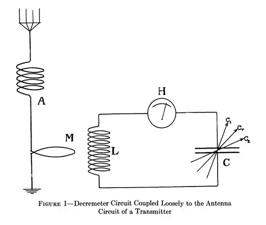

Some notes on the Doolittle Decremeter describe that implementation as a "transmitter antenna tuner" and indeed the circuit diagram from the NIST decremeter paper looks to be in that vein as well:
Simple circuit diagram from decremeter paper
Am I right to understand that rather than measuring a signal directly, a decremeter essentially measured what we would now call the "Q" of an antenna, and in that way — indirectly — would determine how long that particular antenna would let a transmitted pulse ring?

Not only the antenna. It would also include the antenna, the tuned LC circuits, and how tightly the antenna was coupled to the latter.
Spark transmitters produced a damped wave. This edited graph from Wikipedia shows one with desirable longer duration.
The longer the system "rang", the higher the average power --which is what the decremeter measured-- and the better the signal could be copied over longer distances.
