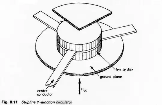

Here's a drawing of how a stripline Y-junction circulator might be built, from a book titled Ferrites at Microwave Frequencies.
y-junction circulator
You'll notice that circulators are inherently frequency-selective due to their cavity nature. So, you'll need the tools to build a well-defined cavity for your frequencies of interest, access to the raw ferrimagnetic discs, the ability to fix, shift them very finely, and potentially to rework them without them losing ferrimagnetism.

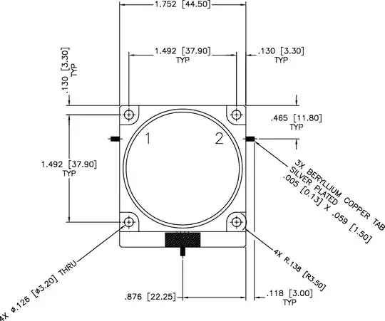

When you put all this into a case that holds the elements into place and ensures all the dimensions, you end up with something like source pdf:
circulator package drawing

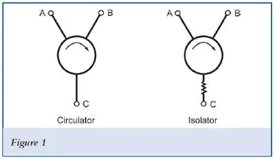

Isolator and circulator
Description of circulator, from Wikipedia article:
A circulator is a passive, non-reciprocal three- or four-port device, in which a microwave or radio-frequency signal entering any port is transmitted to the next port in rotation (only).

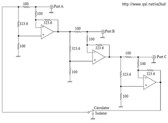

This circulator schematic from VA3IUL uses CLC406 op-amps and covers DC to 100 MHz.
Circulator schematic from VA3IUL
Found at the YO3DAC VA3IUL Homebrew RF Circuit Design Ideas website.
