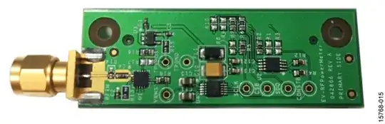

They do. For example, Analog Devices (ADI) has a few of them. This demo board stuck out:
Analog Devices CN0399
ADI CNO399 evaluation board for the ADL5904 power meter IC
What it does is relatively straightforward:
  1. There's an envelope detector, like in Phil's answer, but with a lot of compensation built-in
  2. There's an analog-to-digital converter, because, well, something's actually got to measure the output
  3. and there's a bit of clean, stable voltage supply circuitry and input matching on there

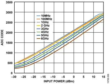

If you can shell out USD 150, just buying that eval board, and then talking SPI to the ADC (e.g. from a microcontroller board like an Arduino, or from a Raspberry Pi), that's a working solution; the "what the ADC says vs what was on the input curves" do look pretty nice:
ADC output over input power graph
CN0399 ADC output over input power graph
Of course, you can also just download the board layout files, have them manufactured for cheap, buy the components, solder them on and probably come out cheaper (but not as well-tested, probably, and on a different FR4 substrate, so the matching might be slightly off).
The purpose of such boards, however, is not production usage; it's to encourage you to use the schematics to build your own power meters from. Maybe the ADC is not what you're looking for? You'd be better off with an Opamp non-inverting amplifier that drives a simple analog voltage gauge? Sure! Just do that, replace the ADC, design your own board. Really, the ADL5904 isn't such a complicated beast to use in a minimal RMS detection setup:

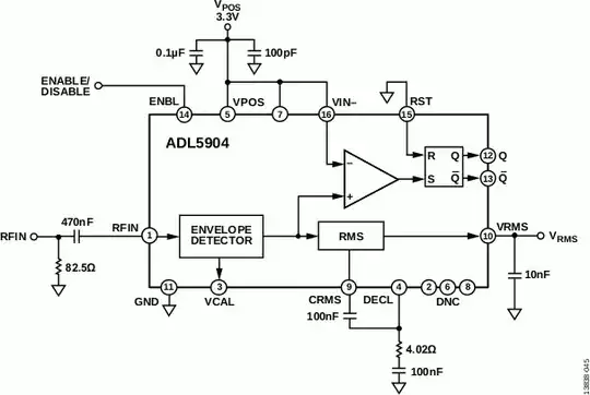

fig. 44 from ADL5904 Datasheet
From the ADL5904 datasheet: Figure 44, Basic Connections for RMS Power Measurement
Counting that: One IC, four capacitors, two resistors; one coax connector for the input, and a stabilized 3.3 V supply IC, plus probably two more caps for that. Done!
As a starting point, this will be quite a bit more accurate over quite a larger frequency range than a much simpler single-diode envelope detector. If you can actually verify your input matching and use your oscilloscope on a low-frequency oscillation to input a known power to the detector, you'll be able to put a high degree in certainty in your power measurements.

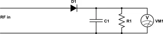

A basic probe looks something like this:
schematic
simulate this circuit – Schematic created using CircuitLab
Ideally the diode has a low voltage drop, like a Schottky diode. But any ordinary silicon diode will work in a pinch.
The capacitor and resistor values aren't really critical as long as the time constant (the resistance times the capacitance) is much greater than the period between cycles. Something like 1nF and 10kΩ would be fine. I usually use whatever I have laying on the bench.
The circuit works because when the input voltage is positive, C1 can charge through D1 up to the peak RF voltage (less the forward voltage drop of D1). But when the input voltage is less, C1 can discharge only relatively slowly through R1.
To use, set up your transmitter to dump power in a dummy load or whatever, and then place this probe in parallel. VM1 can be an ordinary digital multimeter because this voltage changes only as fast as the RF output power, which for an unmodulated carrier, will be DC.
It's important that the leads on everything left of C1 are kept short. Otherwise the added inductance of the long leads will introduce significant errors in the measurement. This becomes more critical with increasing frequency.
To convert the measured voltage to power:
  1. add the forward voltage of D1
  2. divide by $2 \sqrt 2$, converting peak-to-peak to RMS
  3. use Ohm's law to calculate power for this voltage, assuming some load impedance
Assuming a 50Ω load impedance, the calculation is:
$$ \text{power} = { \left(V_\text{measured} + V_{D1} \over 2\sqrt 2 \right)^2 / 50\Omega } $$
For low power levels where the forward voltage drop of D1 represents a significant fraction of the output voltage of the transmitter, accurately characterizing that voltage drop is critical for accuracy.
The simplest method for determining the voltage drop is to read it from the data sheet, but behavior at RF may not be accurately characterized.

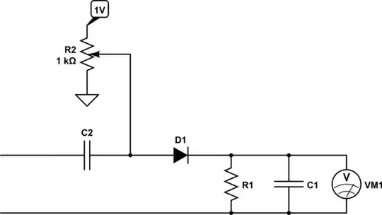

A more sophisticated approach could bias the diode to compensate for the forward voltage drop:
schematic
To use, temporarily short the input terminals, providing an input of 0V. Adjust the pot for minimum voltage, then turn it up to the point where the meter just starts to measure some voltage. You've now biased the diode so it will turn on at 0V, at least for DC.
The bias can be further tuned if you have or can build an attenuator of known value. Say you have a 3dB attenuator: this represents a halving of power, and because power is proportional to the square of voltage, a reduction in voltage by a factor of $\sqrt 2$.
Perform one measurement, then again with the same input power but with the attenuator. If the diode is properly biased, the voltages measured by the meter should differ by a factor of $\sqrt 2$: any difference is likely due to uncompensated diode voltage drop. Correct it by adjusting the pot or by manually adding a correction factor in the calculation.
Accuracy could be further improved by adding a transformer on the input to increase the voltage, thus rendering error due to the diode less significant.

  • Niice answer! Especially like the how-to-use section! – Marcus Müller Mar 26 '20 at 09:40
  • Is your explanation really how it works, though? In my head, it's not, at all! You're arguing the diode effectively works as a half-wave rectifier, right? (<-- honest question, I might be misinterpreting you.) But: the bias should always have the diode in forward operation, so what the diode actually does is introduce a nonlinearity (which in the end is a mixer, mixing the input signal to 0 Hz ($f_{in}-f_{in}$) and harmonics $f_{in}+Nf_{in}$), and the low-pass kills all the harmonics, so that the scope measures the 0 Hz part. – Marcus Müller Mar 26 '20 at 09:43
  • @MarcusMüller I don't know, maybe that's a valid frequency domain explanation of the same thing? In my head, it's simply a peak detector, and the bias only compensates the forward voltage drop of the diode. Once the circuit has reached equilibrium, the diode spends most of its time reversed biased or below the forward voltage. – Phil Frost - W8II Mar 26 '20 at 18:09
First off, a 1 Watt transmitter puts 7.07 volts RMS across a 50 ohm load, or 10 volts peak. So most any diode detector circuit using a silicon signal diode (perhaps a 1n4148) would be plenty accurate for ham uses. For a 0.1 Watt QRP transmitter (3.16 volts peak), a schottky 1n5711 diode would still keep it accurate within 10%. If the voltmeter has a 10meg impedance (to keep diode currents low), you could accurately measure down to 0.01 Watts using that 1n5711 and a calibration chart. Note that the voltage drop across a diode is a logarithmic function of the current, that drop can be astonishingly low when currents are under a microamp. Germanium diodes can have lower voltage drops than schottky diodes, though are hard to obtain and are more sensitive to temperature. Many shops selling cheap 1n34a's these days actually ship a schottky instead.
Phil's diode probe looks good, though the meter sees peak, not peak-to-peak, so should divide by sqrt(2) to obtain the RMS voltage, not 2*sqrt(2). I would do away with R1, relying instead on the meters input resistance to perform that function, keeping diode currents to a minimum. The bias source may not be as useful as you might think, since larger signals will create larger diode currents and thus larger diode drops.

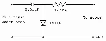

Most homebrew RF probes use a diode with low voltage drop to rectify the RF. You then measure the resulting pulsed DC voltage to determine the power. Most people use a germanium diode like a 1N34, but these can be hard to find. You can use a schottky diode instead. You want the voltage drop across the diode to be as low as possible. A diode with a high voltage drop like the 0.7 volts of most silicon diode will distort the reading.
Add a high value resistor, 4.7 megaohm works well, and small capacitor, 0.01 microfarad for example. Connect them up as shown.
There is still going to be distortion cause by the voltage drop of the components, especially the diode. This will be noticeable at QRP power levels.
Some dummy loads include a rectifying diode that lets you measure the voltage to determine the power going into the dummy load. They basically are including a RF probe in the dummy load.
Jim
  • 1,613
  • I think you have the capacitor and diode flipped. – Phil Frost - W8II Mar 25 '20 at 20:53
    "Most people use Germanium": yeah, but just because someone told them "most people use...", not because it's a good idea. So, your Schottky recommendation is spot on. – Marcus Müller Mar 25 '20 at 21:07
  • Maybe you can add a word or two on how measuring using this works? I can't figure it out – Marcus Müller Mar 25 '20 at 21:09
  • It's really only "most people" in the 50s to the 70s that would have used germanium. These days, most people can't even buy a germanium diode and there's really no reason to use them. https://ham.stackexchange.com/questions/9133/why-are-germanium-diodes-specified-in-amateur-radio-designs – Phil Frost - W8II Mar 25 '20 at 21:42
  • @PhilFrost-W8II eBay has many germanium diodes for sale. – rclocher3 Mar 25 '20 at 23:32
    @rclocher3 True, ebay sells all kinds of obsolete electronics. But seeing as how the entire electronics industry has moved on to higher performance, cheaper components 50 years ago, perhaps it's time the amateur radio community does, too? – Phil Frost - W8II Mar 26 '20 at 00:00
  • @PhilFrost-W8II I'm not saying that using germanium diodes is a good idea, only that if some well-meaning hobbyist sees a project saying to use a germanium diode, then the hobbyist may well do so, not knowing any better. – rclocher3 Mar 26 '20 at 00:12
