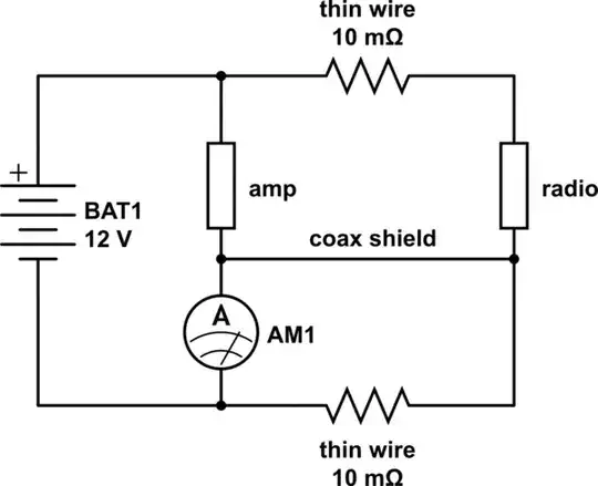

If I understand the description correctly:
schematic
simulate this circuit – Schematic created using CircuitLab
If that's all it is, I wouldn't say it's any big deal. Whenever you have multiple paths to ground, current will split between them. It's these currents that keep "ground" approximately the same voltage everywhere: an essential assumption in the design of most electronic equipment.

  • You understand the description perfectly, that schematic is exactly how it's wired, with assumptions for the resistance values anyway. Thanks for illustrating it and for the reassurance that I might not have a problem at all. As far as the voltage drop in the radio's power leads, that is a concern of mine as well just from a battery life standpoint, and I'm already using larger leads than came with the radio's own supply, but I intend to beef them up further. There's just that compromise between better conductivity and the point at which bulky stiff cables to an HT become quite inconvenient... – MoTLD Apr 15 '20 at 23:55

An anecdote: I had problems with my station which included computer-radio interconnections; some of my devices (RTL-SDRs) would lock up when I powered on my Yaesu FT-897. I eventually tracked this down to the power-on inrush currrent of the radio passing through coax shields and the chassis of the antenna switch that both were connected to.
I solved the problem by replacing the fuse (an element with resistance, after all) in the negative power lead of the FT-897 with a jumper (keeping the fuse in the positive side). This way, the negative power wire's impedance has been reduced compared to the paths not intended for power.
So, the above is an example of one kind of problem that can happen, and a general precaution to take:
  • Make sure your power wires are fat and securely connected.
  • Make sure there is no way to have a positive connection without a negative.
  • Don't use an ammeter or current shunt on the negative lead, except where there is no other negative-side path (e.g. the battery terminals, or an otherwise-isolated load, but not interconnected components). Not only will it cause shield currents, it will read inaccurately since some current is bypassing it.

  • Thanks for answering, lots of good info here! I thought the problems with the amp at 10.7V might be related to this DC on the braid situation, but the more I think about it I think it's just the extra voltage drop and the amp not being able to handle such low voltage in general. I will definitely keep in mind the advice to keep any negative-lead current shunt between the battery and _all_ the equipment instead of in line with any particular piece of equipment to avoid misreadings, especially since that's how my panel meter must be rigged. – MoTLD Apr 15 '20 at 20:41
