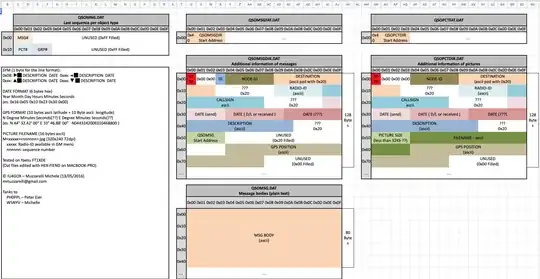

I've also found this spreadsheet that might help
yaesu file structure

    I’ve found this spreadsheet with the file structure. This might help also https://docs.google.com/spreadsheets/d/1PwzVF22pcLmB04uWrRkx8IWbQs3NnVsqAb-y3qHnhVk/edit – Gabriel Sep 01 '20 at 16:05
  • @Gabriel That looks like it might deserve to be an answer, rather than being in a [comment](https://ham.stackexchange.com/help/privileges/comment). I suggest you edit your answer and include [it](https://docs.google.com/spreadsheets/d/1PwzVF22pcLmB04uWrRkx8IWbQs3NnVsqAb-y3qHnhVk/edit), along with a screenshot. – Mike Waters Sep 01 '20 at 18:39
