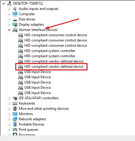

I have connected my brand new RigExpert AA-35 to my Windows 10 PC via the provided USB cable, but the AA-35 does not show up in Device Manager. There is no COM port assigned to it, nor does it show up in USB devices. Also, and this is very strange: I can install AntScope2 (in its default directory) and read data from the AA-35 when I first run the AntScope2 after installing it. After closing and then reopening AntScope2, however, AntScope2 does not see the AA-35. I have to reinstall the software in order to see the AA-35 again. I have to reinstall the software every time I want to get data from the AA-35. Please advise.
Edit: after email conversation with RigExpert (heard from them the very next morning!) it turns out I was looking in the wrong place for the device.

    Does the AA-35 show up in Device Manager now? – progrmr May 07 '20 at 15:35
  • Yes. It always did, I was looking for it in the wrong place, expecting there to be a USB to Serial "translation" (for lack of a better term). I edited my original text to show you where it was hiding out. – K8KV May 07 '20 at 23:05
    My AA-1400 shows up under "Ports (COM & LPT)" as "USB Serial Port (COM4)". Running Win 10 1903 – progrmr May 07 '20 at 23:58
  • Alex from RigExpert "First of all, I want to note that the AA-35 Zoom analyzer is an HID device and it does not create a serial port for it when connected to a PC." – K8KV May 08 '20 at 01:35
