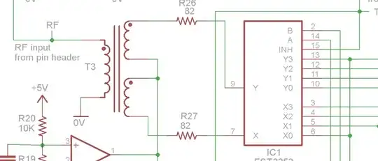

You'll find voltage baluns in plenty of circuits. For example,
the QRP Labs receiver module:

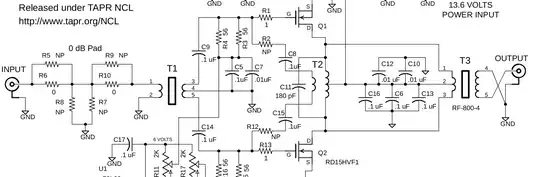

HPSDR Pennywhistle (twice, T1 and T3):
The Elecraft KX3:
A voltage balun can do some things a current balun can not.
Firstly, the turns ratio can be varied to provide impedance transformation. Some of these circuits use something other than a 1:1 turns ratio to optimally load the transistors.
Also, a voltage balun provides galvanic isolation. This can be useful for example to avoid ground loops which might be problematic with audio interfaces. It also allows a DC bias to be added: all three of these designs make use of that feature.
