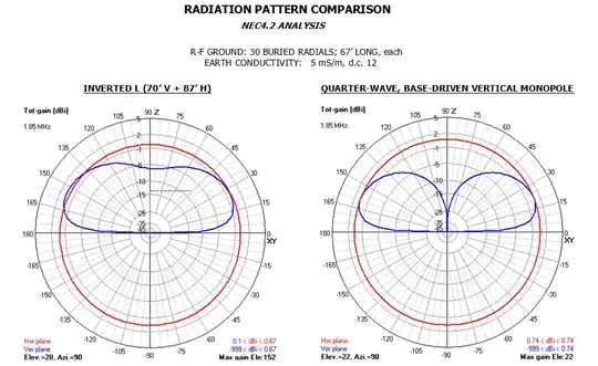

Below is the result of a NEC4.2 comparison of the radiation patterns & gains of the two configurations of radiators, with other things the same.

  • So am I reading the results correctly that the vertical has 0.74 dBi - 0.67 dBi = 0.07 dB more gain than the inverted-L? Also it looks as though the vertical plot of the inverted-L shows more gain in the 180° direction than the 0° direction, but that's not what the horizontal plot says. Of course we don't know what elevation angle was used for the horizontal plot. – rclocher3 Jul 13 '20 at 13:47
    A comparison of bandwidth would be interesting – Phil Frost - W8II Jul 13 '20 at 14:48
    rclocher3 commented: _.. the vertical has 0.74 dBi - 0.67 dBi = 0.07 dB more gain than the inverted-L?_ Correct, for the az/el conditions shown in the lower left corner of the plots. The v-plane plot there is a 2-D slice across the radiation envelope looking at it from an azimuth angle of 90 degrees on the polar grid. Maximum relative gains lie in the direction opposite that of the horizontal wire of the Inverted L. – Richard Fry Jul 13 '20 at 15:32
