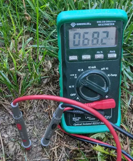

Surely a 1m copper stake provides better ground connectivity for a vertical dipole?
What really matters is conductivity. Current doesn't just go in the ground rod and then it's done. It has to flow through the surrounding soil.
Soil isn't a very good conductor:
(68.2 kΩ, says the display)
Now imagine how much lower this resistance would be with a copper wire between the meter probes.
Of course a ground rod has more contact area than my meter probes, and also what's relevant is not the DC resistance, but the resistance at RF. The multimeter probes stuck in the soil make an easy if not accurate demonstration, but just take my word for it: soil isn't nearly as good a conductor as copper.
In fact, soil is such a poor conductor that lightning would rather arc through 6 feet of air to get to a Beverage antenna than flow through the soil.

Upvoted. However, you are measuring the DC resistance here, but the RF resistance is what is important. I know you already know that, but you might want to put something in your answer for others. I've lost count of all the posts where the OP shows a good DC resistance and follows that with "I measured that with my ohmmeter and it looks good to me!" – Mike Waters Jul 22 '20 at 20:36
Thanks for the link to Tom's site. Wow! @AdamPalmer would also do well to study [his main page about grounds](https://www.w8ji.com/ground_systems.htm). – Mike Waters Jul 22 '20 at 21:33
