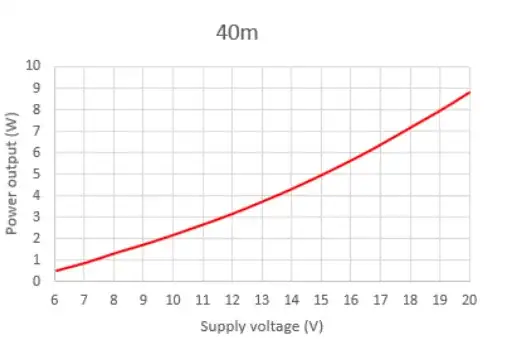

I've bought the QCX+ 40 m band radio. I will be powering this off a 12 V battery. I read on the manual the RF power at 12 V is just 3 W whereas on 15 V it is 5 W. Should I buy a boost converter for the battery to up the voltage to 15 V?

It makes a difference of:
$$ 10 \times \log_{10}\left(3 \over 5\right) = 2.2 \:\mathrm{dB} $$
How big is 2.2 dB? See How big is a decibel?
It's also relevant to note: if the 12V battery is lead acid, the charged voltage can be as high as 13.7.
Furthermore, while a boost converter might further increase your transmit power, it's likely to make noise which will degrade your receive performance.

The difference between 3 W and 5 W is 2.2 dB, which is about a third of an S-unit. (An S-unit is 6 dB.) The question is, how much does that mean to you? That depends on what kind of operating you do, or want to do, with your QRP rig.

For any transmitter, if you double the power, this might seem a lot, but at the other end at a receiver the signal will increase by only 3 dB which is half an S point.
So an increase of 3W to 5W is 2.2 dB which is a bit less than half an S point.
This change is negligible and you won't notice much difference.
However if the level of your transmitted signal is down in the noise at a receiver, it could make the difference between being able to hear it or not.
To answer your question, it is probably not worth the effort to try and increase the supply because no one will notice. Having said that every bit counts and increasing the supply will help a little bit.
Personally i would only make the supply 15 V if it was easy to do.
