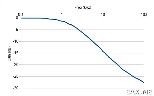

I would like to have a convenient tool to measure filters and amplifiers in 20 Hz - 20 kHz frequency range. Currently I'm doing this with a signal generator, an oscilloscope and LibreOffice. It's not the fastest and not the most convenient method, but it gives a nice looking result:

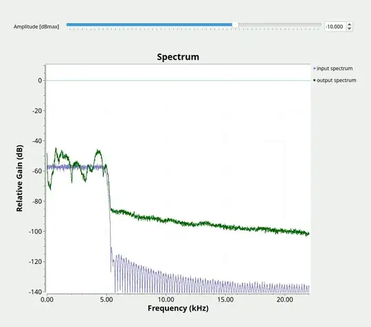

When run (purely with my laptop speakers and microphone, outdoors, lots of noise around me) that's what it looks like:
Running program
The soundcard plays the blue line, to the best of its abilities. It digitizes the microphone audio, which yields the green line.

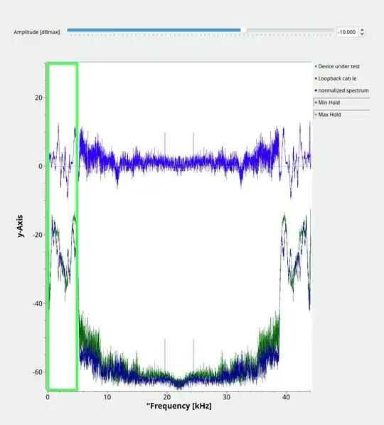

normalized/calibrating soundcard sounder
and the output would look like (I tried to highlight in green the area you need to look at; the rest is just noise, because we're suppressing the output signal with the low-pass filter everywhere else). Again, this isn't what a filter response would look like if you measured it with the method (sound card output-> Device under test -> left sound card input; sound card output -> cable -> right sound card input), because this is just "sound over the air with birds", but I think a picture still helps understand what's happening here:
Differential Channel Sounder Display
