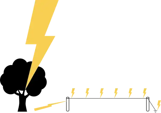

One of my favorite lightning anecdotes is this story by W8JI. He had lightning strike a tree, blowing the bark off down the trunk, and making a huge hole in the ground. And then some 20 feet away, the current arced to a Beverage antenna and traveled the length of the antenna to get to the ground on the other side of the antenna.

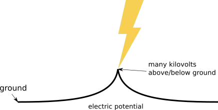

The reason for this is soil is a pretty poor conductor. The strike isn't done as soon as it hits soil. Lightning is transferring a huge quantity of electric charge into the soil, and all that charge now wants to spread out over the entire Earth. This means high current in the soil, and since the soil has resistance, by Ohm's law this also means high electric potential.
The potential was high enough to create an electrical arc several feet long so the strike current could get to the antenna wire, which presented a much lower impedance path to the distant ground.
So because the soil has resistance, and the strike current is very high, the electric potential near where the current is entering the ground is very high, and decreasing with distance:
If one ground rod is placed near another, the current from one ground rod will increase the electric potential of the other, thus making it a less effective sink for current. Two ground rods near each other is never worse than just one ground rod, but increasing the spacing of the ground rods reduces their interaction and makes an overall lower impedance path to ground.
