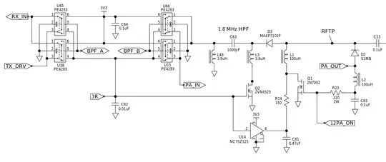

The KX3 uses an integrated PIN diode switch, PE4283:
The PE4283 has an absolute maximum power input of 34 dBm, which is only 2.5 watts. This part is advertised as a "high power" RF switch, which gives you some idea of the expectations people have for solid-state RF switching.

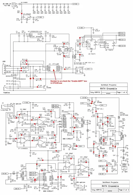

The Softrock RXTX uses a BS170 MOSFET (Q10, bottom-right):
