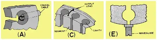

Paraphrasing the Wikipedia entry for the magnetron, we learn that,
... a stream of electrons passes by the openings to metal cavity resonators and causes microwaves to oscillate within, similar to the way a whistle produces a tone when excited by an air stream blown past its opening. The resonant frequency is determined by the cavities' physical dimensions.
A magnetron produces microwave energy, but it is not meant to radiate that energy. The microwaves which oscillate within the cavity resonators are not polarized in the sense that an antenna can be horizontally, vertically, circularly, co-polarized or cross-polarized. Rather, they correspond to particular field modes.
This page on magnetron coupling methods informs us that the energy is coupled from the magnetron to the load - which could be an antenna - via an E-field loop (A), an H-field loop (C), or an aperture (E), as shown below:
