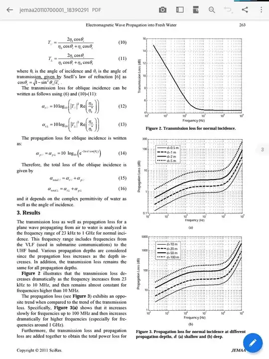

Here is some useful scholarly information about the signal attenuation (in dB) of EM waves through freshwater at various frequencies and depths. You will find a formula that you can use.
You will also need to know the antenna gains, transmitter power levels, and the receiver sensitivity at the bandwidth.
Electromagnetic wave propagation into fresh water

    Exactly what I've been looking for, but it's making me wait 4 hours to award the bounty D: – Galaxy Nov 23 '20 at 22:16
    Nice references! As I remembered from my Prof, propagation in fresh water isn't the real problem, it's penetrating the surface, and designing proper antennas for use under water. It seems 2.4 GHz is right out, but perhaps 48 MHz TV would be possible for 10-15 metres in fresh water. – tomnexus Nov 23 '20 at 22:53
