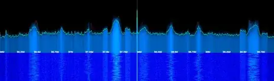

A bolt of lightning has an average center frequency of about 16 kHz, which varies with the height of the bolt.
This is a distant stroke that I captured on one of my SDR lightning receivers, using three 4-turn 1-meter dia. vertical loop antennas, spaced 120° apart:
Blitzortung lightning waveform and FFT spectrum (Ignore the apparent 50 mV offset)
  • Note how the energy on this particular stroke is concentrated below 20 kHz, in the LF region (very typical). The two higher frequency, broad areas are almost certainly due to ionospheric Doppler shifting.
  • The harmonics extend up into to the VHF region. However, since this FFT spectrogram's vertical axis is based on power —and the filters roll off the unneeded higher frequencies— the much weaker harmonics do not display.
    Having said that, occasionally I see many significant ionospherically-Doppler-shifted "bounces" up to 80 or 90 kHz. They appear as equally-spaced bell curves that decrease in height with each higher frequency-shifted bounce.
The 16 kHz figure is based on many observations of mine over a long period of time.
This signal was sent to the blitzortung.org and lightningmaps.org servers in Europe, and was displayed on the map at https://lightningmaps.org as a line from my rural location in SW Missouri to the distant (>1300 km) stroke.
