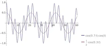

First case: Input below the LO, LO phase = 0
Mathematically, this is
$$ \cos(t) \times \cos(0.7 t) $$
Plot it:
It's plain enough to see this does indeed produce an output that's a low frequency sinusoid superimposed on a higher frequency one. Now, we are really only interested in the lower frequency term (1 - 0.7). We know that lower frequency term has $\omega = 0.3$, what's it's phase? Just eyeballing it, it looks like 0. So let's plot that again, with the low frequency term $\cos(0.3 t + 0)$ included:
So we can say:
$$ \cos(t) \times \cos(0.7 t) = {\cos(0.3t + 0) \over 2} + \dots $$
Here, $\dots$ denotes the higher frequency term that we don't really care about for this example.

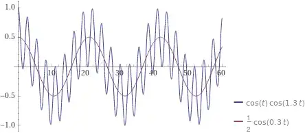

Second case: Input above the LO, LO phase = 0
$$ \cos(t) \times \cos(1.3 t) = {\cos(0.3t + 0) \over 2} + \dots $$
OK, the higher frequency term has changed of course, but the $\omega=0.3$ term we are interested in is exactly the same. It doesn't seem like there's any way to differentiate negative from positive frequencies from this.

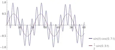

Third case: Input below the LO, LO phase = $-\pi/2$
$$ \cos(t-\pi/2) \times \cos(0.7 t) = { \cos(0.3t - \pi/2) \over 2 } + \dots $$
OK, there's still an $\omega = 0.3$ output, but the phase has changed. That would make sense, because the phase of the LO also changed. Moving on...

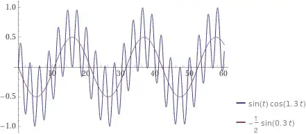

Fourth case: Input above the LO, LO phase = $-\pi/2$
$$ \cos(t-\pi/2) \times \cos(1.3 t) = { \cos(0.3t + \pi/2) \over 2 } + \dots $$
Similar to the last case, but the phase has flipped by 180 degrees. It seems the phase of the mixer's output changes depending on whether the input was above or below the LO!
