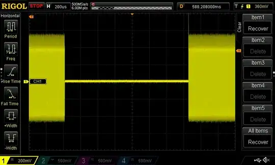

I think I figured this out. By looking at VFO with an oscilloscope I could catch a brief glitch (~1.5ms) in the signal when the frequency is changed:
It was hard to notice because you can't easily trigger on this. I had to manually trigger single captures while tuning for some time to see this.
Then by googling "si5351 output glitches" I've found this piece of code on the QRP Labs website. The comment states:
Reset the PLL. This causes a glitch in the output. For small changes to
the parameters, you don't need to reset the PLL, and there is no glitch.
Then I realized the source of the problem and how to fix it. Here is the original version of my code:

Here si5351_SetupCLK0 is called every time the frequency is changed. The procedure changes the PLL, MS and Rdiv settings for the channel. As an author of this Si5351 driver I'm well aware that PLL settings are always the same for frequencies below 81 MHz (also this is a documented behavior which can be relied on in the future versions).

Now the expansive call si5351_SetupPLL is made only once, the glitch is gone and the popping sound is eliminated. Well, almost. You can still hear a very quiet popping when the antenna is disconnected. But there is no popping when the antenna is connected. Interestingly you can observe the exactly same behavior in QCX transceiver made by guess which company.

Since it happens when switching frequencies, I suspect glitches of some form in the local or beat frequency oscillators' output.
The mixers simply multiply the "signal" by the oscillator. Any noise or glitch in the oscillator outputs will be reflected in the mixed outputs.
You may be more sensitive to BFO glitches, since the output is at DC, not a higher intermediate frequency.
The glitch could be as simple as a phase change in the oscillator or a missed cycle. That will add a DC component to the signal, which will turn into a DC shift in the mixer output.
Since the passband of the mixer and audio amplifier probably does not go to zero Hz, it will sound like a click.

    Do you have a scope you could use to look at the BFO and LO outputs? Set up a loop with a gp pin to use as the scope trigger, switching the oscillator to frequency A when you raise the pin and back to frequency B when you lower it. Look for anything interesting, like shifts in the average value, missing cycles, or lengthened cycles. You should see nothing on the BFO, but if you do you've found the source of the clicks. Then comes the process of finding the cause. If the BFO is clean, look at the IF output for any visible glitches. If there are glitches in the IF, check for LO glitches. – cmm Jan 20 '21 at 14:24
