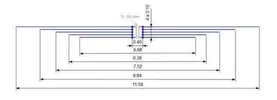

Spacing of parallel dipoles influences the bandwidth you can achieve on every particular band. The smaller the spacing, the more narrowband antenna becomes. However, there is a trick you can use to achieve a little larger bandwidth while not spacing the dipoles too much. See my website here.
The trick is to use a configuration I call a split feed point.
    Welcome to StackOverflow! Please describe the trick in your answer here rather than just pointing off to your site. If your host changes its linking scheme, a broken link will quickly frustrate people who want to know more. – user3486184 Apr 17 '21 at 08:57
    The trick is difficult to explain without a drawing. So, I will add a picture to my initial answer. – Jacek Pawłowski SP3L Apr 17 '21 at 10:07
  • That is very interesting - I have not seen that method of feeding dipoles before. Another method I have though of is to use a remote switch to put resistors in the dipoles not being used. This, I think, would add enough impedance that they would not accept power and detune the operational dipole. Well, at present I am considering a flag pole antenna, at much greater expense, as my HOA (that would be my wife) doesn't want the wires over the yard but will accept a flag pole. I still may experiment with the dipole, however, just not a permanent fixture. I will look at your postings. – mike zias Apr 17 '21 at 20:24
  • I don't understand how those two 50 ohm coax pieces work. How long are they? And it appears that (1) the shields are only connected to each other, and (2) the center conductors are shorted by the other connections. – Mike Waters Apr 18 '21 at 18:16
    Two 50 ohm cable pieces form a shielded balanced transmission line of characteristic impedance 2x50=100 ohm. You may read about such lines in the latest ARRL Antenna Book, page 23.28, Figure 23.26. Its length is 40 cm. Although 40 cm may look not so much, it can not be approximated as a short circuit in the frequency range 14-30 MHz. You need to treat it as antenna element or as a complex LC circuit perhaps. We can generally say, that such a feeding method changes phase differences among the RF potentials in various segments of the antenna parallel wires. – Jacek Pawłowski SP3L Apr 19 '21 at 11:17
  • Ah. I didn't realize that the *4 x 0.10* was metric at first. Thanks. – Mike Waters Apr 19 '21 at 15:32
  • Hello and welcome Jacek! We discourage answers that are just links, because links rot: URLs change, sites go away, etc. Would you please edit your answer to include at least the basic idea along with the link? – rclocher3 Apr 19 '21 at 15:51
  • Well, I have answered the question in two first sentences. The third and last sentence is not exactly a part of the strict answer. It is only related to the original question. So, I thought it would be inappropriate to describe the method in detail. The asker may be completely uninterested in that. – Jacek Pawłowski SP3L Apr 21 '21 at 06:49
