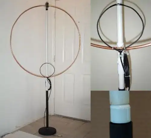

Magloop example: This one is from KR1ST, but mine is similar. Depending on size of the small, low-Z coupling loop - looses in main loop increase and it becomes less selective. enter image description here
    What do you mean by *oscillate*? And on my old low-Z magnetic loop, I used a separate coupling loop and a low-Z preamp. Can you please edit your question and insert a picture or drawing of your magloop? – Mike Waters Feb 01 '21 at 17:55
    @MikeWaters I updated the question. I am also using separate coupling loop, and noticed that when coupling loop is larger - system becomes less selective. – BarsMonster - R2AYN Feb 02 '21 at 14:54

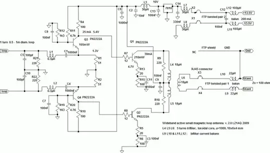

But if your objective is to use the loop on a wide frequency range without retuning, this is the opposite of what you want. Instead, you want a low-impedance amplifier, the lower the better. You can think of the loop as a current source by Faraday's law of induction. The lower the input impedance of the amplifier, less impedance to this current. LZ1AQ has an example of such an amplifier:
In this design there is a passive filter at the input to attenuate the AM broadcast band and avoid overloading the amplifier. The low input impedance is achieved through the common-base Q3 and Q4, then Q1 and Q2 further buffer the signal and are designed to drive a twisted pair.
