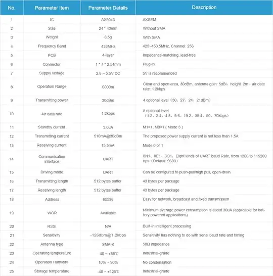

  1. We are using a 433 MHz RF module. Is the antenna should be 433 MHz or can it be more? Can I use 868 MHz antenna?
  2. Is 433 MHz RF Module enough for the 10.000 feet? (The distance could be more than 10K feet.)

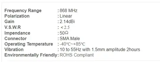

  3. There are some details of our RF Module. I found this antenna but I'm not sure that it can work at 10.000 feet (The total distance could be more than 10K feet. We are assuming that distance is 20K feet). Can someone say to me his/her thoughts?
RF MODULE DETAILS RF MODULE DETAILS
https://www.m2mmarket.com.tr/e32-ttl-1w-302
ANTENNA DETAILS
https://www.m2mmarket.com.tr/U151,36,2j010-868-mhz-rf-anten-2j.htm

You should use an antenna that is designed for the frequency of your RF module unless you have a compelling reason to choose a different antenna. A properly designed antenna will make the best use of the RF module's output power and avoid damage to the RF module.
If you decide to use an antenna designed for a different frequency range from the RF module, you should probably design and insert an impedance-matching network between the RF module and the antenna to protect the RF module from power reflected by the mismatched antenna. Here's an example from the datasheet for a PCB-mounted chip antenna:

Well-known electronic parts distributors sell a variety of monopole, helical monopole, dipole, patch and chip antennas that might work in your application. Your antenna of choice must survive high acceleration in atmosphere and add as little drag as possible to the rocket assembly. The size, shape and mounting arrangement will all be important. An antenna with very low gain (large negative dB value) and/or low efficiency will not radiate the signal from the RF module as well as an antenna with more gain and higher efficiency.
The application notes section of the Linx Technologies web page contains numerous useful documents with which you could educate yourself. I refer you, in particular to AN-00501: Understanding Antenna Specifications and Operation, which discusses all of the important factors you need to consider when choosing your antenna.
I provide the links only as examples of your antenna options. I am not affiliated with any distributor or manufacturer.

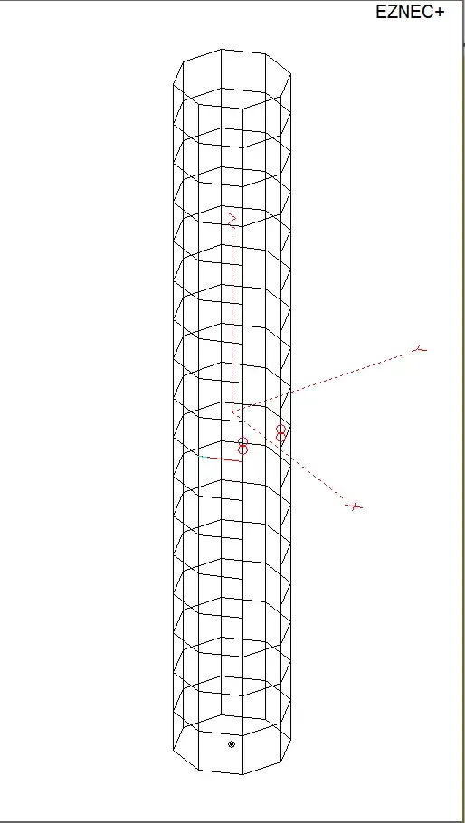

It may be possible to use a conductive surface mounted on the outside of the rocket body as an antenna. Not knowing the dimensions of your rocket and without the benefit of any design equations, I used EZNEC+ to create a crude model of a cavity-backed cylindrical slot antenna:
The "cylinder" is about 6.5-m tall and 920-mm in "diameter," the "slot" is about 4.2-m tall and 381-mm wide, producing this SWR curve with a 200-ohm reference impedance:
"Shortening" the slot while maintaining its "width" raises the resonant frequency and the feedpoint impedance. A "shorter" and "narrower" slot will produce a match at the desired frequency.

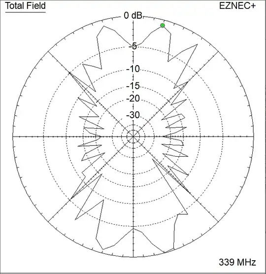

The radiation is strongest and fairly omnidirectional off the ends of the cylinder:

  • What would the polarization be? I imagine it would be difficult to match it if the rocket starts to roll. Is there a way to adapt this idea to make the signal circularly polarized? Maybe wrap a spiral of wire around the outside of the rocket body? – mrog Feb 19 '21 at 22:36
  • @mrog I've seen several cavity-backed slot antennas with crossed slots to achieve circular polarization. Not sure how to implement that on this form factor. – Brian K1LI Feb 20 '21 at 01:07
