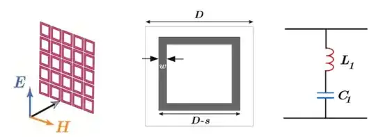

In this article an incident electromagnetic plane wave on a frequency selective surface made of a periodic sequence of square metal rings is considered.
The authors say:
When the transverse magnetic field faces the vertical strips, it induces current in the loop. This current leads to a secondary magnetic field around the strips, within which magnetic energy is stored. Thus, the vertical strips have an inductive effect.
Well, there are some things I don't understand:
  1. How can a time - varying magnetic field induce current in vertical strips and so in the loops? I have always been using the Faraday law in this way: time - varying magnetic flux across a surface => Induced current along the loop that defines that surface.
In this case, the magnetic field does not enter the surfaces of the loops.
  1. Can we say that it's the Electric field of the wave that moves electrons in the vertical strips and causes current to flow?

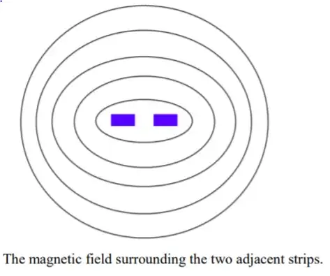

  2. Next, the article says that the magnetic field surrounds two adjacent vertical strips, like in the following picture:
Is it the magnetic field created by induced currents in the loops?

Next, the article says that the magnetic field surrounds two adjacent vertical strips, like in the following picture: -- Is it the magnetic field created by induced currents in the loops?
This graph seems to be a simplified representation of two parallel wires that carry current in the same direction (either directly in or out of your monitor). A single current-carrying wire has a magnetic field that loops around the wire. If you place two wires next to each other, then exactly between these two wires one wire creates a magnetic field pointing up and the other pointing down, causing them to cancel each other out. The authors of the paper use this to illustrate how they calculate the combined inductance of the two parallel wires from adjacent unit cells.
